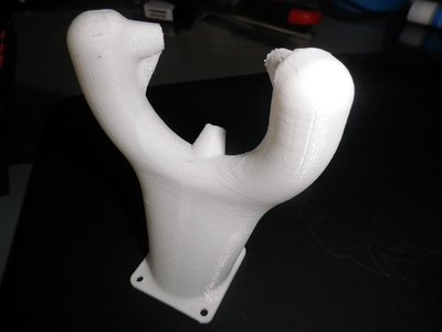

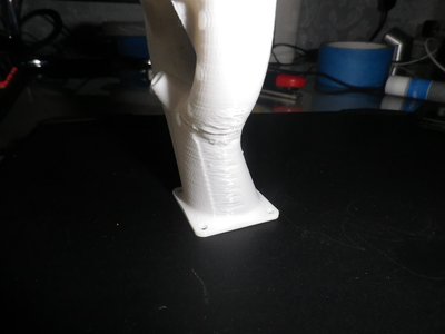

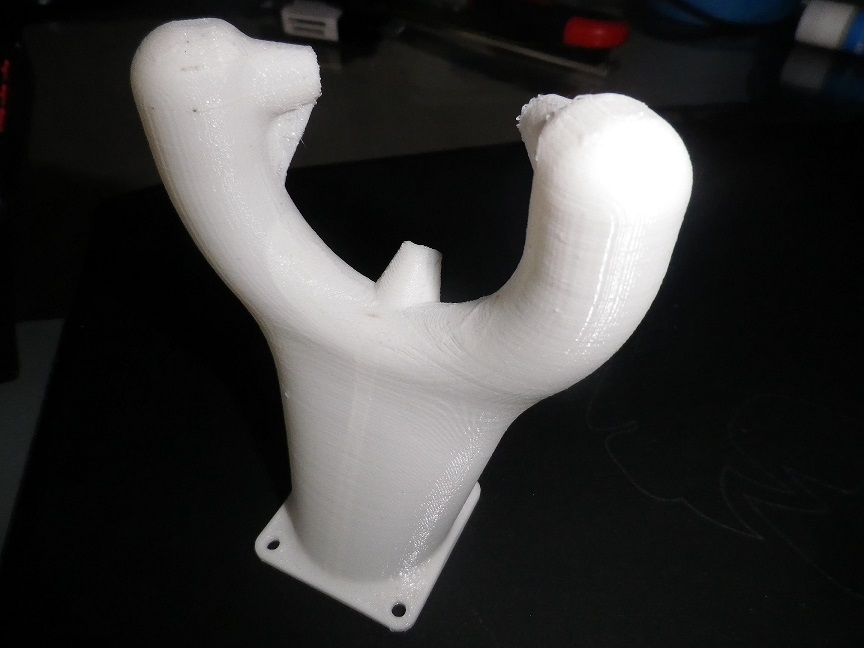

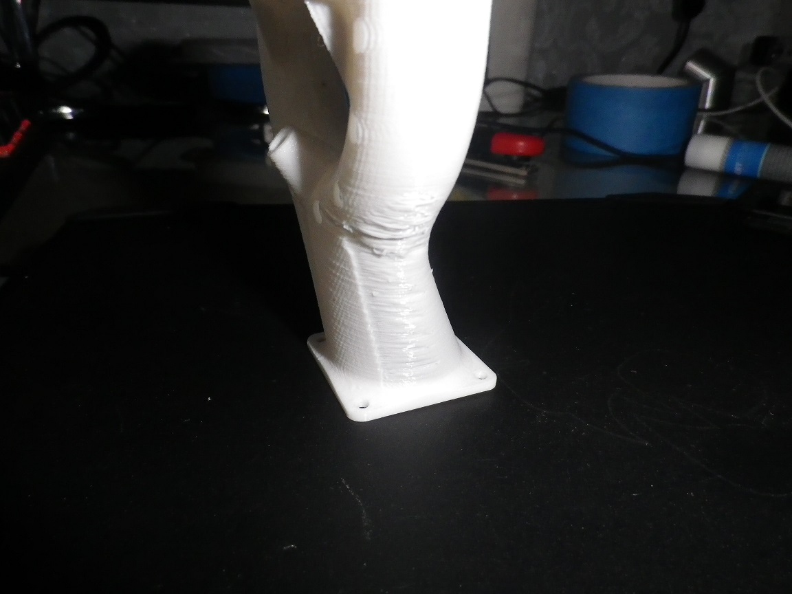

Hi, can somebody help me please, I have a K8200 with lots of upgrades, a twin K8204 trapzoid, a K8203 1.75mm hot end as well as other things to help improve print quality, I just printed off a new fan nozzle and mostly I am happy with the print, except for one part at the rear of the print is very very poor
brian442
Posts: 1243
Re: print quality advice
You might want to try adding support for those steep overhangs. Or lower the layer height in that area.
PinballGeorgio
Posts: 94
Joined: Sat Apr 11, 2015 10:58 am
You need a better cooling fan/ system, but I bet you are printing this because of that :)
