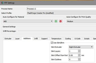

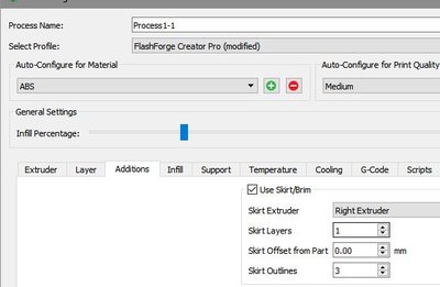

I have attached pictures if you want to see for yourself. What have they been working on for so long?
Why would it need to change your skirt settings? It already uses the same skirt settings that you had setup for the original process.[email protected] wrote:It doesn't change the Skirt/brim option from the first process
From the photo you posted, it looks like the first layer of the second process is starting perfectly on top of the first process. That's what I would expect, so maybe you should post more info about what you wanted it to do.[email protected] wrote:and it doesn't automatically calculate the second process' start layer correctly
