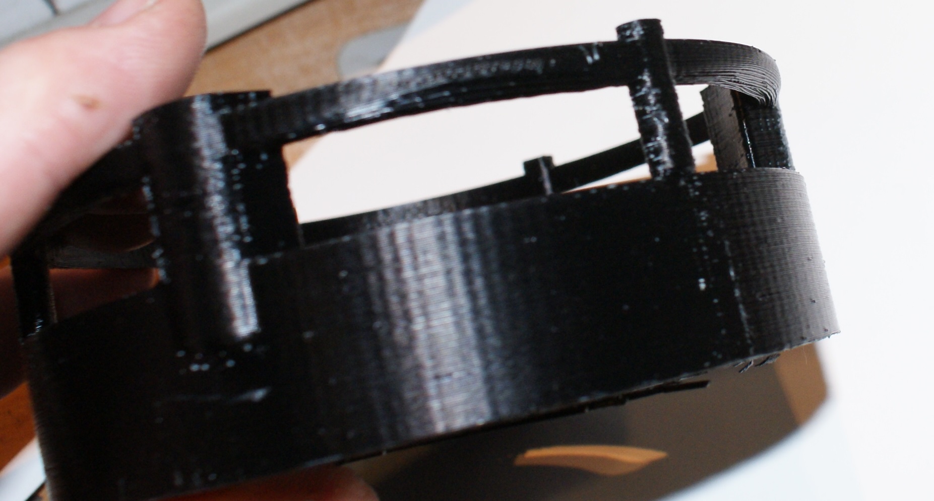

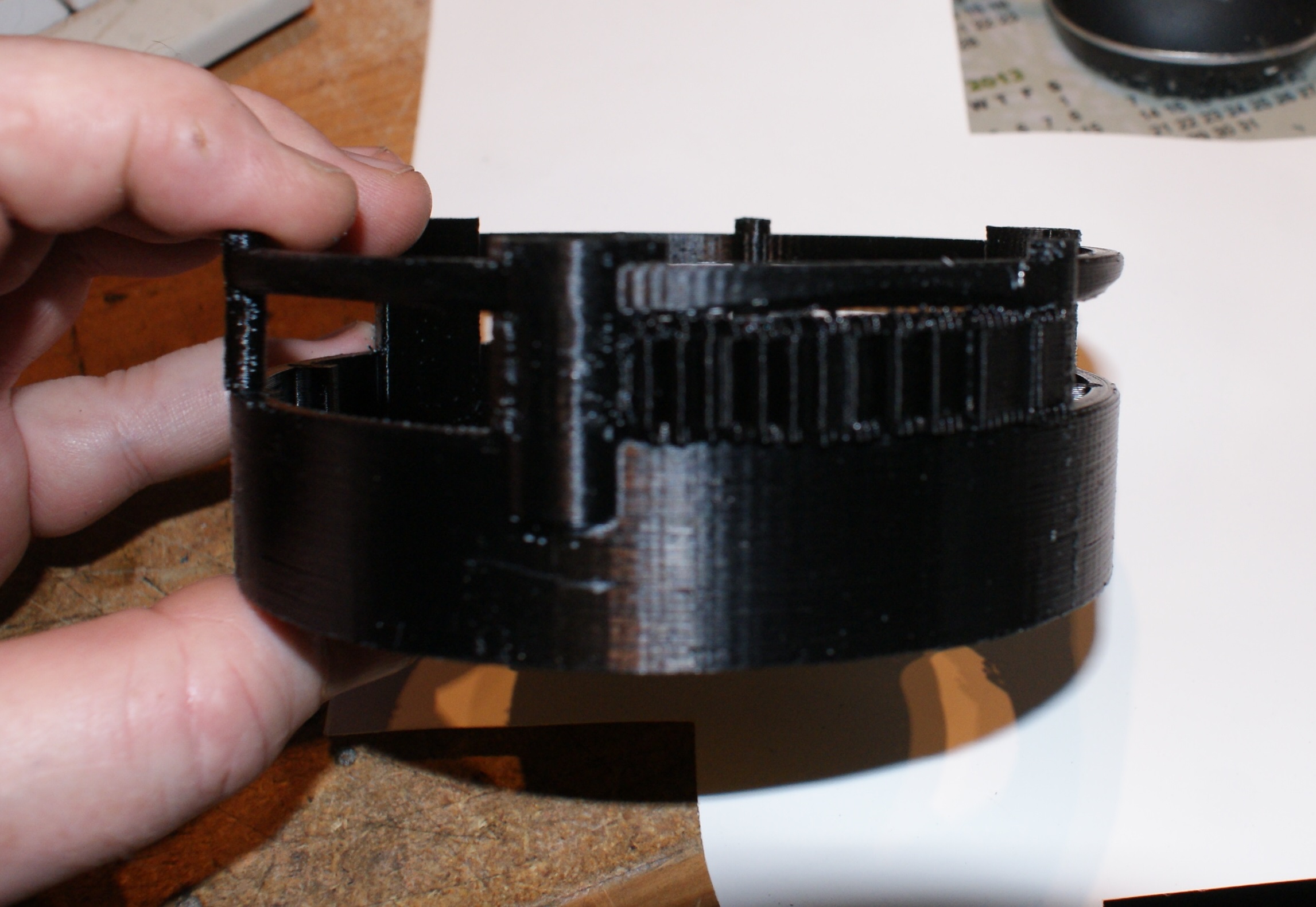

Bridging issues with new S3D 4.0
I swear every time they come out with a new version I have to completely relearn how to use S3D to get get decent prints. OK. I have an apparent bridging issue that wasn't there before. Other than the prints looking like absolute crap, the only major issue is the bottoms of the bridges. I attached a couple of pictures to show what i am talking about.

With S3d you can only select 1 upper vertical separation layer or higher for the top of the support. At zero layers the support bonds to the print and at one layer I get the messed up bridges. It looks like the bridges are printing in the air instead of flat over the support dense layers. I have tried lowering the extrusion % but then I start to get layer separation on taller prints.
