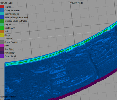

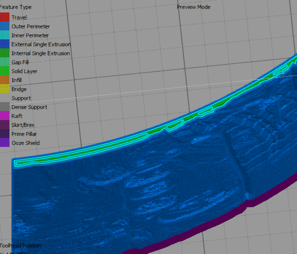

I made a lithophane. SImplify 3d Will not slice it. it gets to calculating infill and just hangs their.
I have had simplify hang on really large prints but this is not large or that complicated. its a 3mm thick curve 210mm lithophane. (STL attached)
I loaded my Ender 2 profile (160x150 print volume) turned it 45' on Z so it fits on the bed
I have it set for 8 perimeters and single extrusion fill and 0% infill
it will not slice. since it got stuck on calculating infill ?? (why its 0% ??) so I set it to something (1%) but it still hangs.
suggestions?

I just tried your file with my Ender-2 Profile and had no problems with slicing.
Even Overlap at 10% was ok. And single extrusion also applied

Just wanted to add a quick note to mention that the issue above is now fixed in Version 4.0.1. You should not have any more issues saving or reloading extremely large STL files.
nerys wrote:it will not slice. since it got stuck on calculating infill ?? (why its 0% ??) so I set it to something (1%) but it still hangs.
This issue was also fixed in Version 4.0.1. I am now able to open and slice the factory file you provided without any issues.
