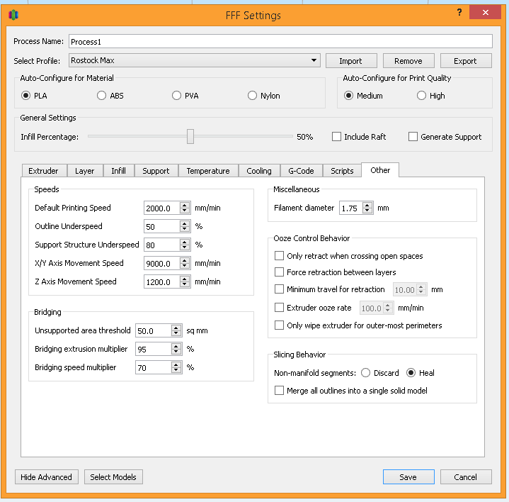

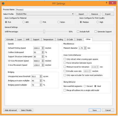

for dual extrusion only, i unchecked all of the ooze settings

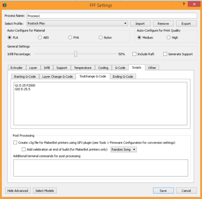

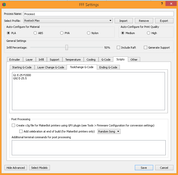

i add this to my toolchange in scripts, the extruder uses absolute distance so this should pull the filament out of the nozzle to the total length of 25, then it will set the distance = 25.5 so it will prime an extra .5mm to account for lost filament

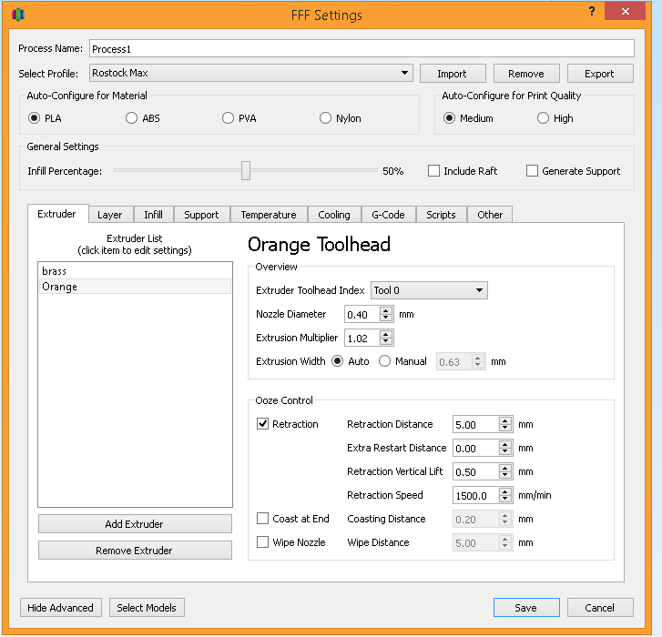

and these are my extruders retraction settings, i dont use any prime here because it will always prime for any pick up and put down.
