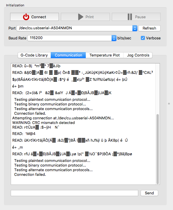

Hello, from today I have this problem with simplify3d, both on windows and mac. Not the printer because I tried repetier and it works perfectly. What happened?.
It's not the usb cable, I've tried three and the problem is the same.
Thank you

Problem solved the baud rate was not the correct one.
