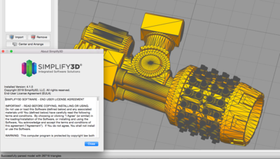

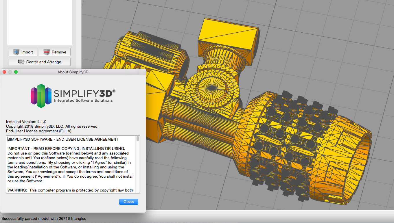

Posts: 250
Re: [FIXED] Error while importing .obj
I’m happy to announce that this issue should be resolved now in the latest 4.1 release. Our team successfully tested multiple obj files from threads mentioning this issue with model importing. As you can see from the picture attached, this specific model definitely works in 4.1.0. This was just one of many improvements to the software. All of which are detailed on our Release Notes page.
