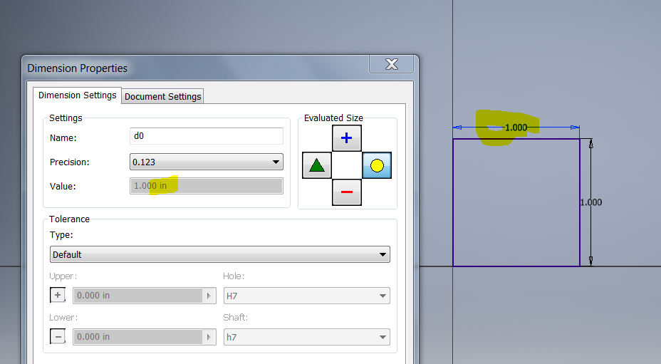

Pic for reference.

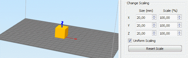

Import an object and do a double-click on it, a setting window opens.
Have a look to Scale %.
If there is a different value to 100%, DKightley is right.
If the value is 100% but the object comes in different dimension, then the reason is to search by the CAD-program.
S3D or other slicers only fulfill what the STL-file is delivering. S3D is using an algorithme that changes automaticaly the dimension in the range of some Millimeters to inches because it is not very probable that an object to be print is so minor.

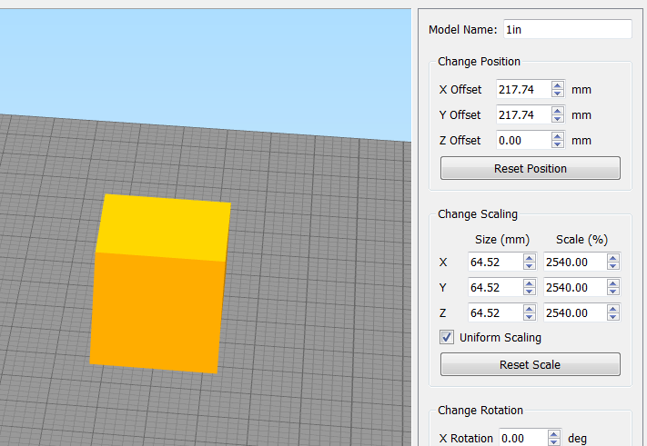

All signs point to an exported 1" in model...however, in Simply3D 4.0.1, does not bring in correctly scaled...see attached. Can I not change the default measurement in S3D to IN vs MM to resolve this? As I do not want to have to scale an item within S3D...rather keep it the same as to how it is designed 1/1 ratio.
Much thanks

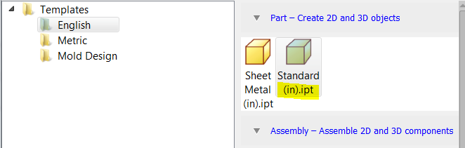

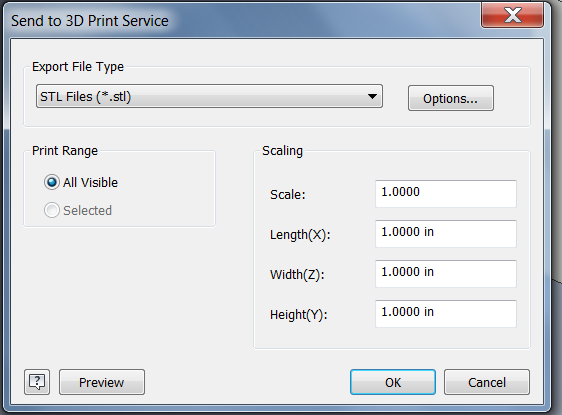

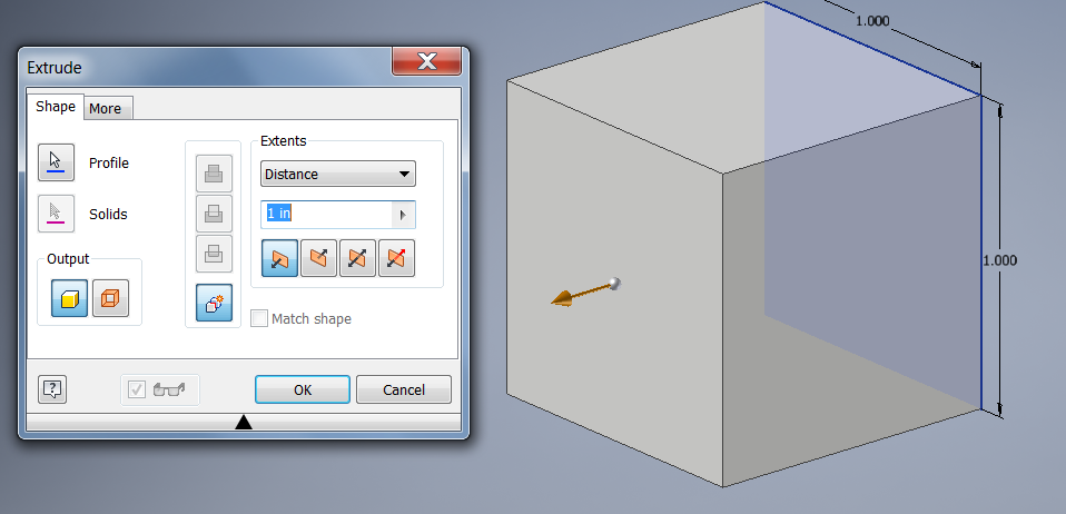

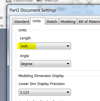

Re: Odd scaling issue Autodesk
more pics
