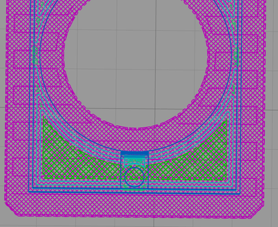

I'm trying to print this model:
https://www.thingiverse.com/make:311723
Do you have an idea how I can get simplify to infill the outer wall?
Re: Thin wall - howto?
....using the Thin Wall and Gap Fill features that were introduced in v4.
https://www.simplify3d.com/software/rel ... ion-4-0-0/
Attach a factory file if you are wanting someone to make the changes to the settings for you....
