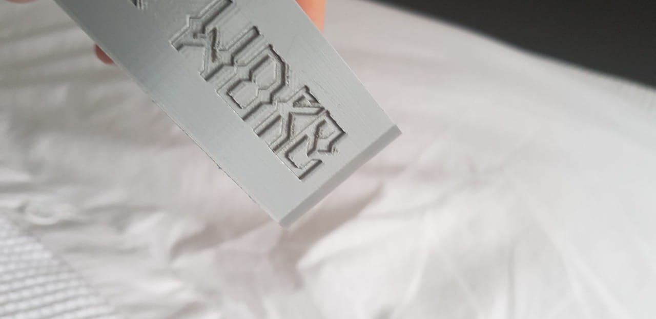

Afternoon S3D!
I'm looking for some help on this print, the print in question turned out flawlessly apart from the text & even that had solid supports,
I've tried new perimeters but I have Stock CR10-S firmware. I've tried different types of supports & slicers and still had the same problem.
Would love some advice!
zemlin
Posts: 434
Re: Terrible Text even with Support
That's called ringing or ghosting.
Avoid sharp corners and right angles, slow down the print speed, especially on outer perimeters. Reduce your acceleration and jerk settings, especially for your outer perimeters.
