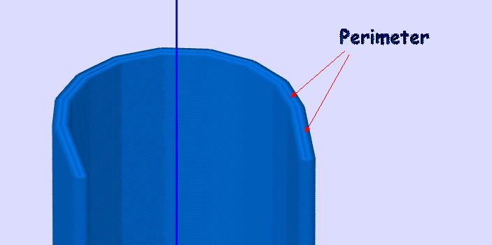

Its amazing how the dictionary definition for the term "perimeter" gets in the way when you try to imagine an object that is formed into a cylinder. If it was a flat profile, then a "perimeter" is an extrusion going down one side, turning 180 degrees and running back up the other side and joining the start point. Extend the flat profile into a "u" shape, and the same interpretation exists. Continue and bend it round so it joins the other edge...and what happens?? The outer "extrusion is now called the "perimeter"...and the inner extrusion is now called ....well, what can you call it??!
Here's some pictures to illustrate the "confusion"
