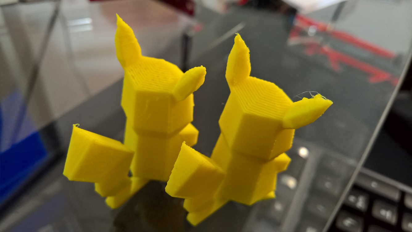

Hello! I am brand new to Simplify3D and first off let me say that it ha cured the mass majority of the issues I have been having with my custom modified CTC 3D Printer.
My printer was a CTC DUAL which I took apart and rebuilt with a Bowden configuration and a Prometheus V2 J-Head hot end. I flashed my firmware to Sailfish 7.7 and installed several other major upgrades to the x,y,z axis. My printer has in general been giving me some trouble with clogging my nozzle mid prints, after switching to Simplify3D I was able to resolve this by lowering my extrusion multiplier which in turn prevents clogging mid print and seems to prevent the formation of a small nub on the end of the filament which in turn is what blocks my nozzle. I am printing in Makerbot True Red PLA at 215c on a heated glass bed (only kept warm).
Thank You!
