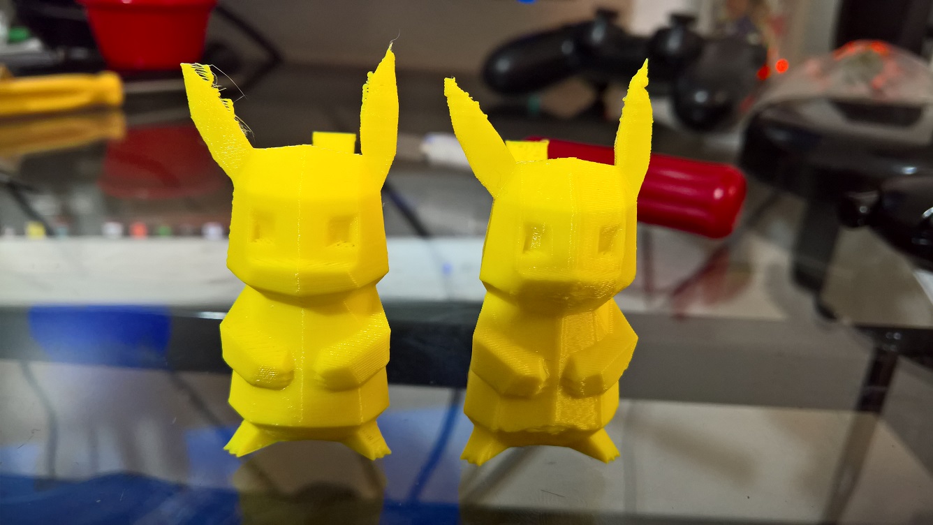

lol, thank you! You should of seen what this printer was spitting out before I did my upgrades to it... I as beyond scared to do the work that I did as it is my first 3D printer but I'd say I did really well considering.... If only I could solve some of these other minor issues. I'm starting to wonder if my filament is to blame.
The right Pikachu in the photo was prior to switching to Simplify3D and making several changes to temps etc... I am still getting weird blobs at retraction sites... Tried adjusting those values to no avail...

Hi Pyr_X I had a similar problem when I first started using S3D (sorted out heaps of others thou :D ) ... In my case it turned out I were trying to extrude too much filament through too smaller nozzle ... I fixed it by throwing away the 0.2mm ones and going to a 0.4mm nozzle.
