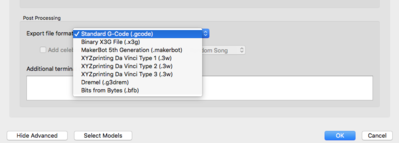

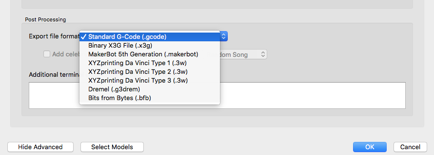

Assuming you the followed the setup instructions and input your printer type/etc (if you didn't, review it - see Help).
If there is no bug, and you input your Marlin printer, you should not see message regarding XYZ brand stl .3w
The field I refer to is in the process panel which should have options related to' your machine.' For mine, they are (below)...
Double click on a Process, it will open the Process panel, select Advanced, select the Scripts tab - that's where it's located on S3d for mac.

Ok, now I see what you are saying. I just created a new profile and it works perfect. The old profile had the "export format" as gcode already but for some reason it still gave the error. The new profile works like a charm. Thanks for your help.
