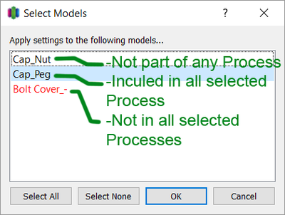

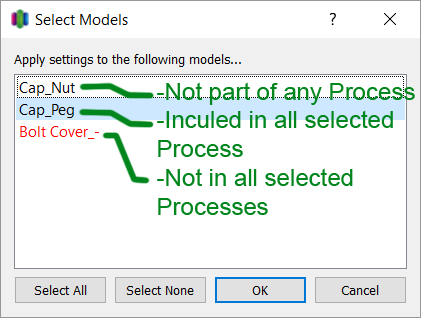

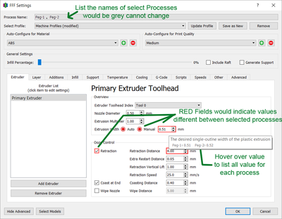

Once a process has been split it would be nice to be able to edit the common part between the two.
With 2 or more selected process anything altered in the fields would change the values between all selected processes.
Se attached for example change to interface. Highlight field in red which are different between selected processes. Maybe show values for first selected process. but highlight if different.
The model selection dialog would also need a change.
The reason I say a color is make it clear to the person the value they see/change is is affecting something different than what they see. also hover over a value would list the values for each process.
Once a process is split it becomes a very annoying time consuming processes to make change you wish to be applied to multiple processes.
