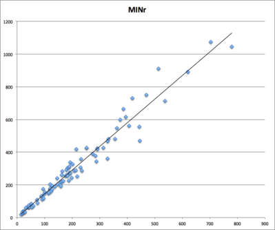

The error isn't likely to be linear though. In my case it's pretty accurate up to about an hour, but beyond that the acceleration and jerk settings of the printer come into play, and the complexity of the print path can make the estimate high or low. For example, see this graph of 91 prints I've done. The X axis is the estimate from S3D and the Y axis is the actual print time. The values are all minutes:
Having a single adjustment factor might get you closer, but it still won't be accurate except for small/fast prints.
