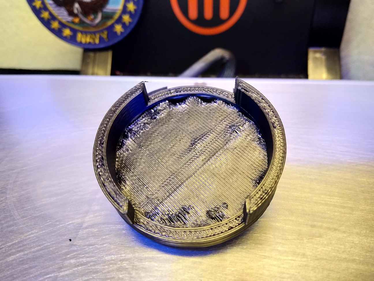

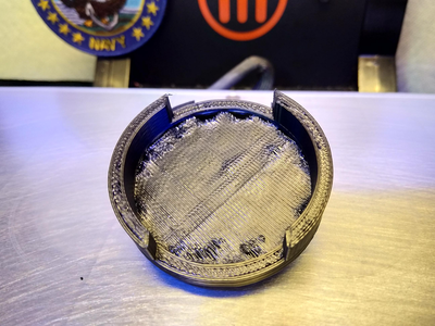

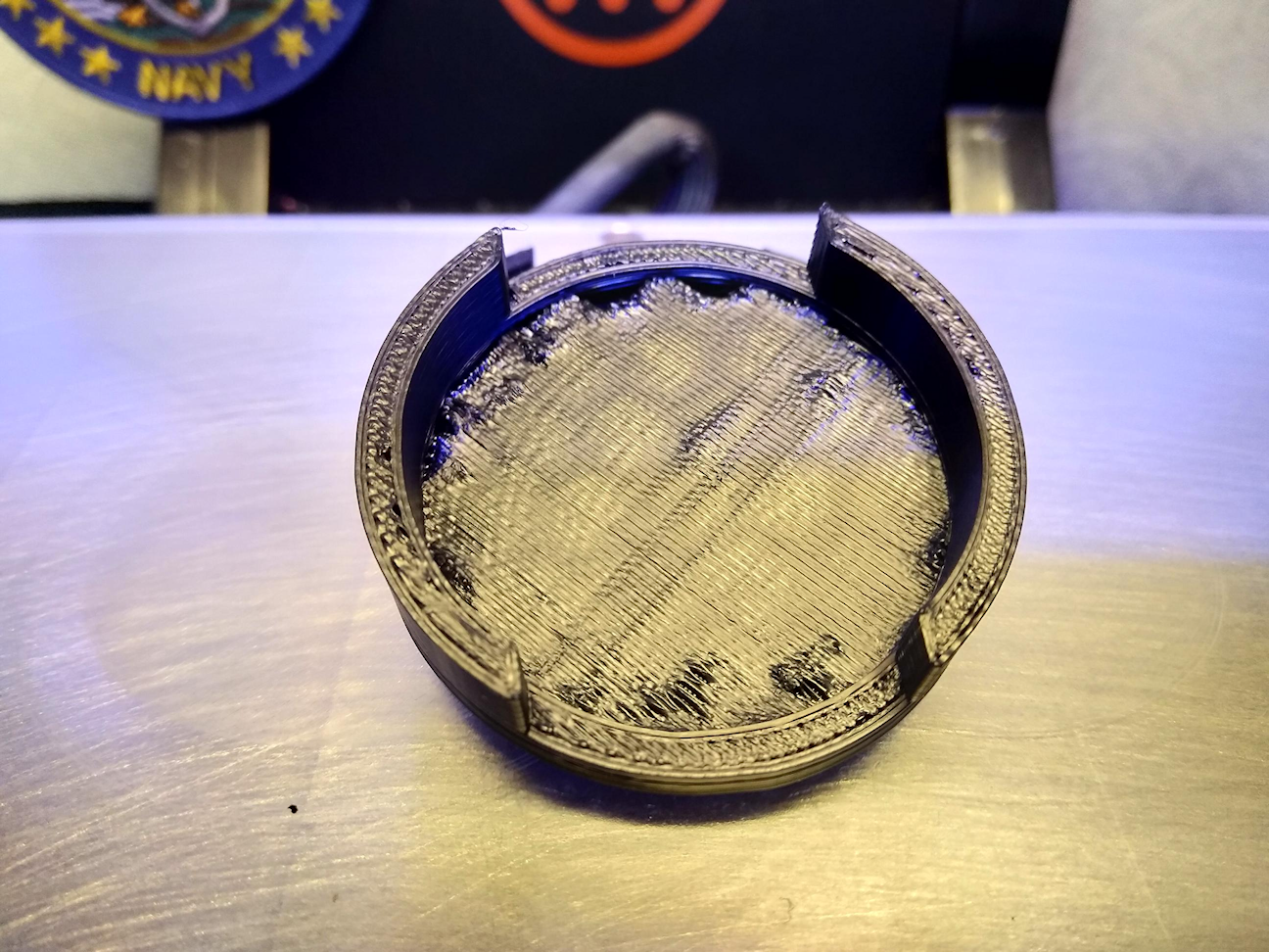

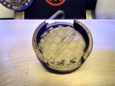

I have a Replicator 2X Printer dual head
Problem 1.) The left extruder fan runs continuously ??? I have asked and asked Makerbot but can never get an answer from them....
Problem 2.) Having an issue with a print [see images] and cant seem to get it cured so it would print correctly....

2nd image

As far as the print this can be solved by increasing the infill density and/or adding more top layers. Also the type of infill will have an effect on this.

And regarding the printing issue, I concur with the answer given.
