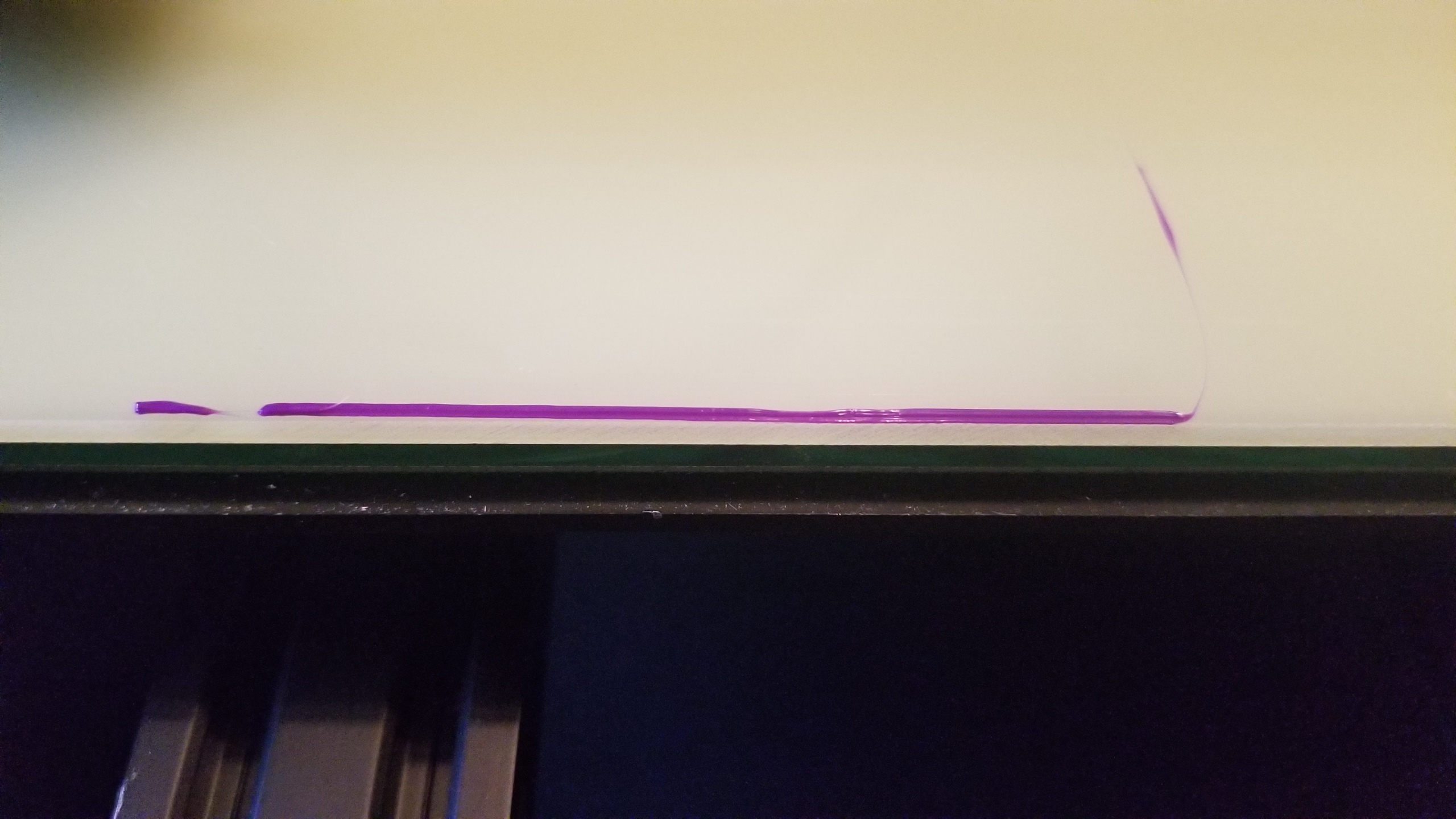

Had a little issue and replaced my fang setup on my CR10 S5...now PLA wont stick to either glass nor PEI. Initial test line prints proper but when the brim starts...wont stick. I may have change a settings in the S3D profile while trying to setup for a litho profile...but cant seem to figure it out. Just need eyes to validate I didnt over look anything and to rule out S3D profile which is causing this event.

By default I print PLA @ 60/210 flawless for most all the PLA I use. In light of this recent issue, I have tried:
Print on my <non-stock> 6mm Glass directly
Print on my <default> 6mm glass and PEI
Bed temps from 50-70
Extruder temps from 195-230
Nothing sticks after the initial line my code makes.
Re: Can I get a second set of eyes....
The usual cause of this is the nozzle not being close enough to the bed.
Adjust the Global-Z field in a negative direction (it will go negative!!) by half a layer thickness and try printing. If it sticks, check the underside is smooth and doesn't show the extrusion lines. If not, or the print still doesn't stick, repeat the adjustment and try again.
If you go too far, the nozzle will virtually stop printing....and you'll need to back off.
Once you get nearer the optimum position, adjust by smaller amounts. Once you hit the optimum, apply the Global-Z offset to all your profiles.

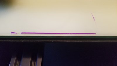

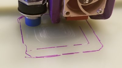

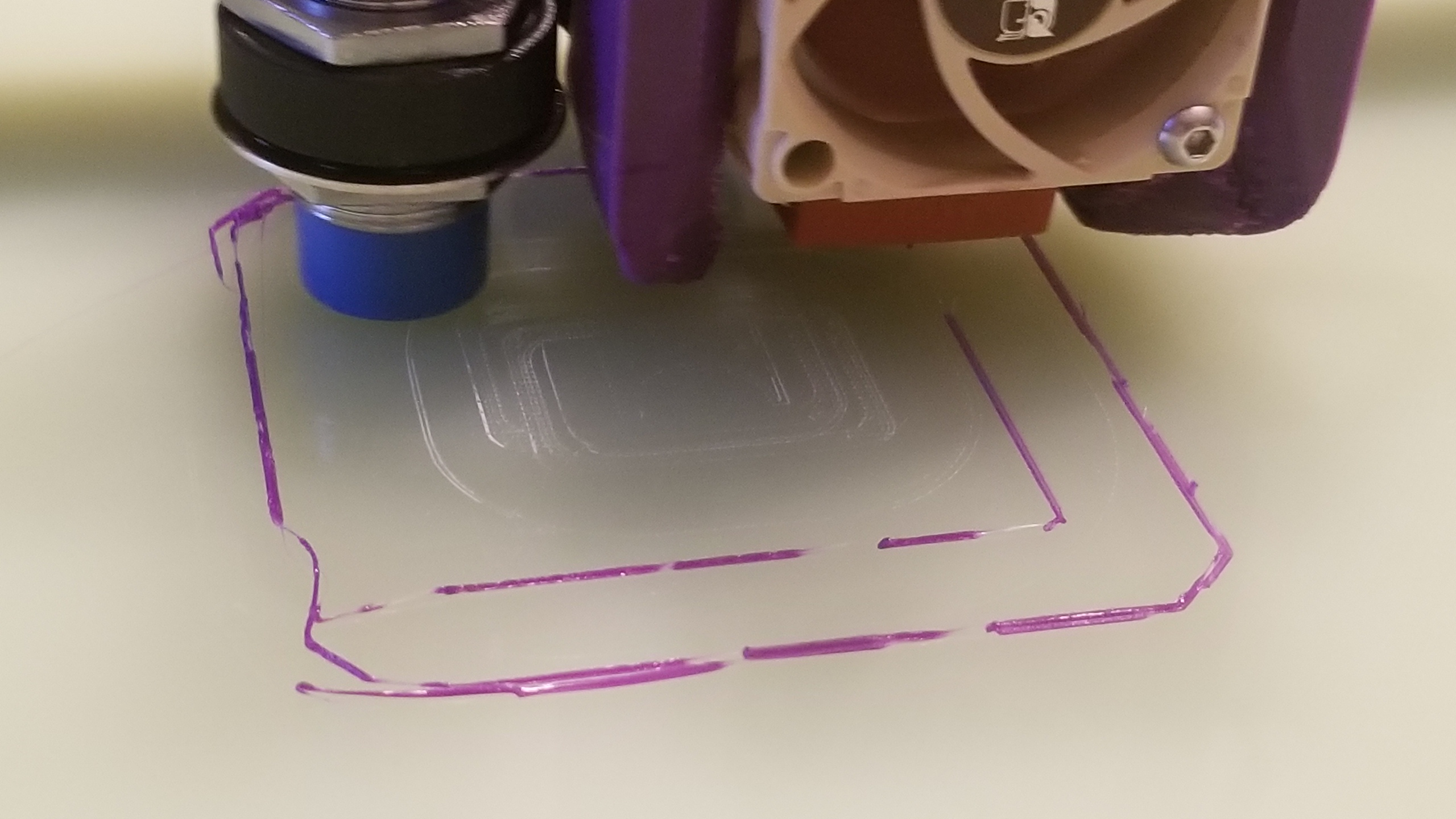

This is what im seeing...
Posts: 1374
Kind of hard to tell but I think the nozzle is too close to the bed.
mthompson239
Posts: 84
Joined: Wed Mar 16, 2016 6:19 pm
I adjusted the babystep to get the proper prime line...but then get the provided layer pic...not a solid/fluid layer.
Posts: 1374
I am not positive for you on this but on my printer at least, the prime line height and the actual part first layer height are going to be different.
I have had times when the prime line was fine but on the part the nozzle went to close to the bed or it has also been to far from it.
I think I would focus on settings for the actual part and not necessarily the prime line.
