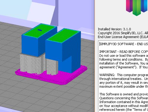

I noticed this after upgrading to verison 4.1 from 4.0.1. I turn on supports then go in an manually create and edit them. The problem only happens when I have more than one model being sliced and printed at the same time. Here is what I do, fully repeatable:
1. Load two models.
2. Turn on supports int he profile.
3. Manually add the automatic supports.
4. Manually remove all supports from one of the two models.
5. Edit supports on remaining model, removing most of them and adding a few more for good measure.
6. Slice both models.
BOTH models will have supports. The one where I edited them (adding and removing) will only have the supports remaining that I allowed it to have. The other model, then one where I removed ALL the supports, will slice with all the supports STILL IN EFFECT. It is as if I did not tell it to remove them.
I have not tried manually removing every support instead of just using the quick and easy remove all supports button...but I should not have to go through all that effort since a button exists which does it for me already.
Updating to 4.1.1 did not fix it. Images are below. As you can see, it is as if I did not tell it to clear all the supports off the second model. How do I make THAT model print without supports while still printing the FIRST model WITH supports?

Followed your instructions to the letter.....and:
I've replicated what you have reported......but let's go further....
Posts: 2210
Re: BUG: 4.1 prints supports when told not to print them
Wed Dec 05, 2018 6:26 pm
If its a bug, then its been there a long time.....
…..but its not a bug! Its normal behaviour.
If you don't want support, auto or manual, then turn them OFF. And you'll need to use two profiles if you want different behaviour on separate stls
Alternatively......a little trick that may work! Tip your build plate so you're looking at the underside......then go through the motions of adding one manual support on the flat bottom of the model you don't want any supports on. Nothing will show....but if you then slice, there will be no supports!

One of the problems with S3D is.....and its by no means a not so good problem.....is that there's so much to remember that occasionally something really basic tends to slip your mind. And that happened to me last night on this thread!!!
The issue (incorrectly) reported as a bug on this thread is really quite a simple misunderstanding in the way some of the functions in S3D work. Automatic supports is one of them. Auto supports are generated for any single part in the build area where the profile has support switched on....provided the part doesn't have any manual supports specified. In other words....it can be useful....and it can be a pain in the neck!
My solution for getting the best out of the auto-support feature is as follows:
1) Set support ON in all profiles with a support resolution of 99mm. This effectively is the same as setting support OFF!
2) When you want supports to be generated automatically, open the Support window, set the support resolution to a sensible value...and click the Auto-generate button. You have auto-supports...but only when you want them.
This way of working runs smoothly into where you want to manually specify supports from scratch....or by auto-genning supports and deleting some out.
Try it! I've used this for years....
