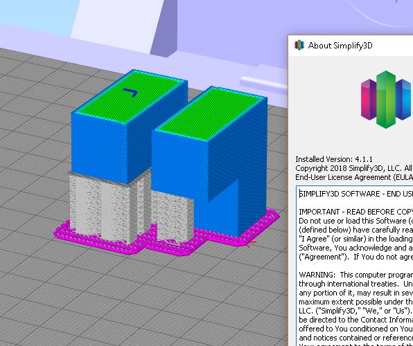

Updating to 4.1.1 did not fix it. Images are below. As you can see, it is as if I did not tell it to clear all the supports off the second model. How do I make THAT model print without supports while still printing the FIRST model WITH supports?

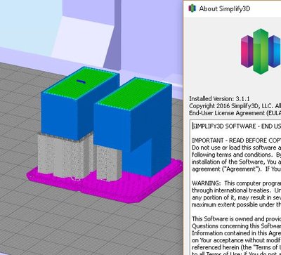

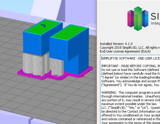

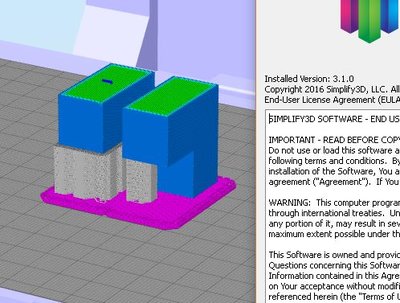

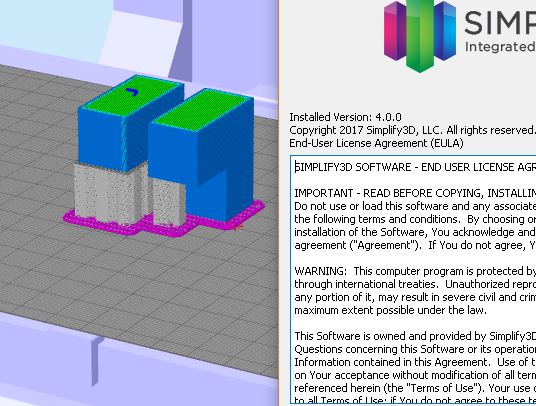

Followed your instructions to the letter.....and:
I've replicated what you have reported......but let's go further....
