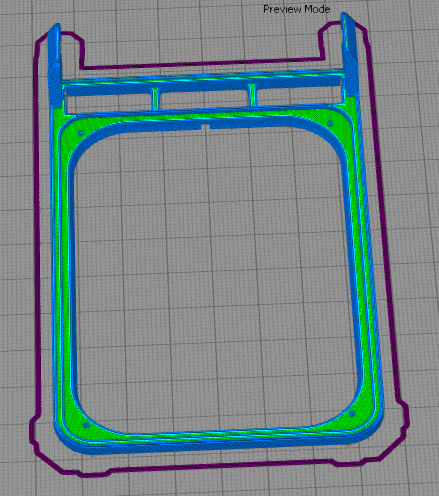

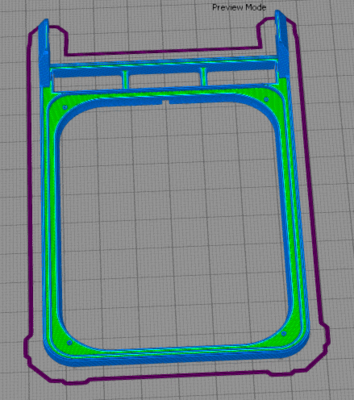

The model starts very thin and gets thicker at layer 6....though only little support is generated at the corners:
This is at layer 5 where only few support is generated at the inside corners:
This at layer 6 with a much wider infill with almost no support underneath:
Does someone know which support setting to tweak to get support printed for the whole new solid layer?

You probably need to check the layer height. The layer needing support may just be too close to the bed for it to generate supports properly.
There are so many variables, that with the info provided it is just a guessing game at this point.
Posting the Factory File would help others to be able to see what may be going on.

The model is laying hollow on the print table. Sink down only 0,5 mm has success.
It seems the support is check on only randomly, no base layer, no separation layer a.s.o.
The First Layer Height with 0,12 mm (0,10 mm x 120%) is very ambitious to a very exact leveled print table.

Move all model up from build plate. 1 to 2 mm. And generate support structures.
