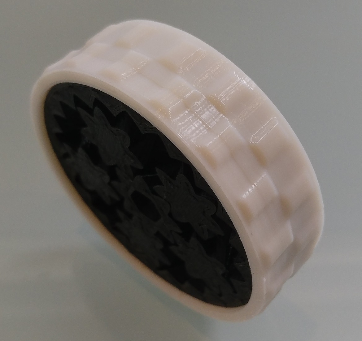

- Tyre: Printed a tyre for the bearing and this was much faster (60mms) and hotter (250 nozzle and 85 bed) else the extruder would slip at this speed. Given the shape (no overhangs etc) it printed quickly and cleanly. Probably not a great material for a tyre as it is too hard and slippery but it is still flexible enough to put onto the bearing.
- Bearing: This also printed using the above settings but the material is not a great choice as there is too much play and the bearing does not freely spin and tends to bind.

Dupont Zytel : After my success with Hytrel, I got a roll of Zytel (same price as Hytrel). It is a Nylon 66 type filament and is also easy to print with little stringing and good bed adhesion..... I just followed the instruction sheet in the box for Temp and Speed, with functional part being able to print faster and hotter and stuff like Benchy needing slower and cooler. I also added some fan (25%) which helped with overhang curl (even though it is not recommended). It comes in one colour, a crisp white. The printed bunchy is tough as but if you take to it with pliers then you can break bits off. The harder bit was getting a dimensional setting working for functional parts like the planetary gear. I needed a ended up using -0.2 so parts would not fuse together bun then the gear had too much slop in it.
