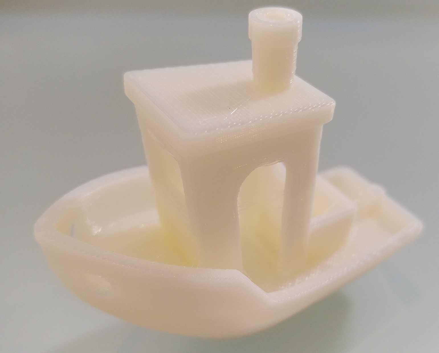

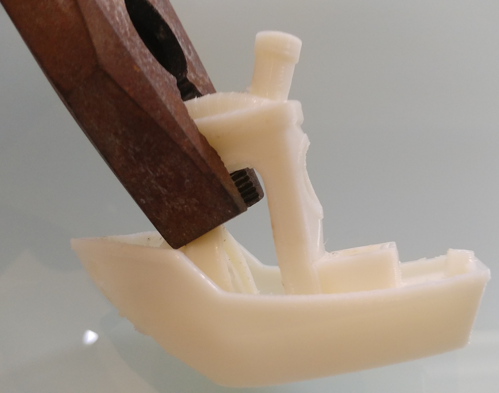

Dupont Hytrel: It's a Shore D 60 - TPC-ET thermoplastic elastomer. I've not printed with these sorts of filaments before and can not belive how tough and resiliant they are. I can not rip or break apart the Benchy though it does hold some deformation from the plyers. Normally you can just snap off the funnel but not with this stuff.
I tried 3 different prints (pics of 2 attached)
- Benchy: Needs to print slow (20mm/s) and cool (220 nozzle and 50 bed) else you get curling on the front of the Boat's overhang. With these settings there was hardly any stringing and bridging was OK. The pic shows how it went straight from the printer bed. What stringing was there was cleaned up with a pass of a heat gun.

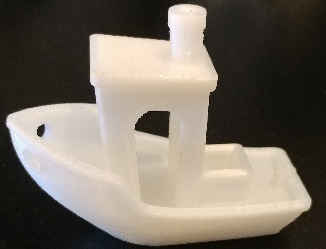

Dupont Zytel : After my success with Hytrel, I got a roll of Zytel (same price as Hytrel). It is a Nylon 66 type filament and is also easy to print with little stringing and good bed adhesion..... I just followed the instruction sheet in the box for Temp and Speed, with functional part being able to print faster and hotter and stuff like Benchy needing slower and cooler. I also added some fan (25%) which helped with overhang curl (even though it is not recommended). It comes in one colour, a crisp white. The printed bunchy is tough as but if you take to it with pliers then you can break bits off. The harder bit was getting a dimensional setting working for functional parts like the planetary gear. I needed a ended up using -0.2 so parts would not fuse together bun then the gear had too much slop in it.

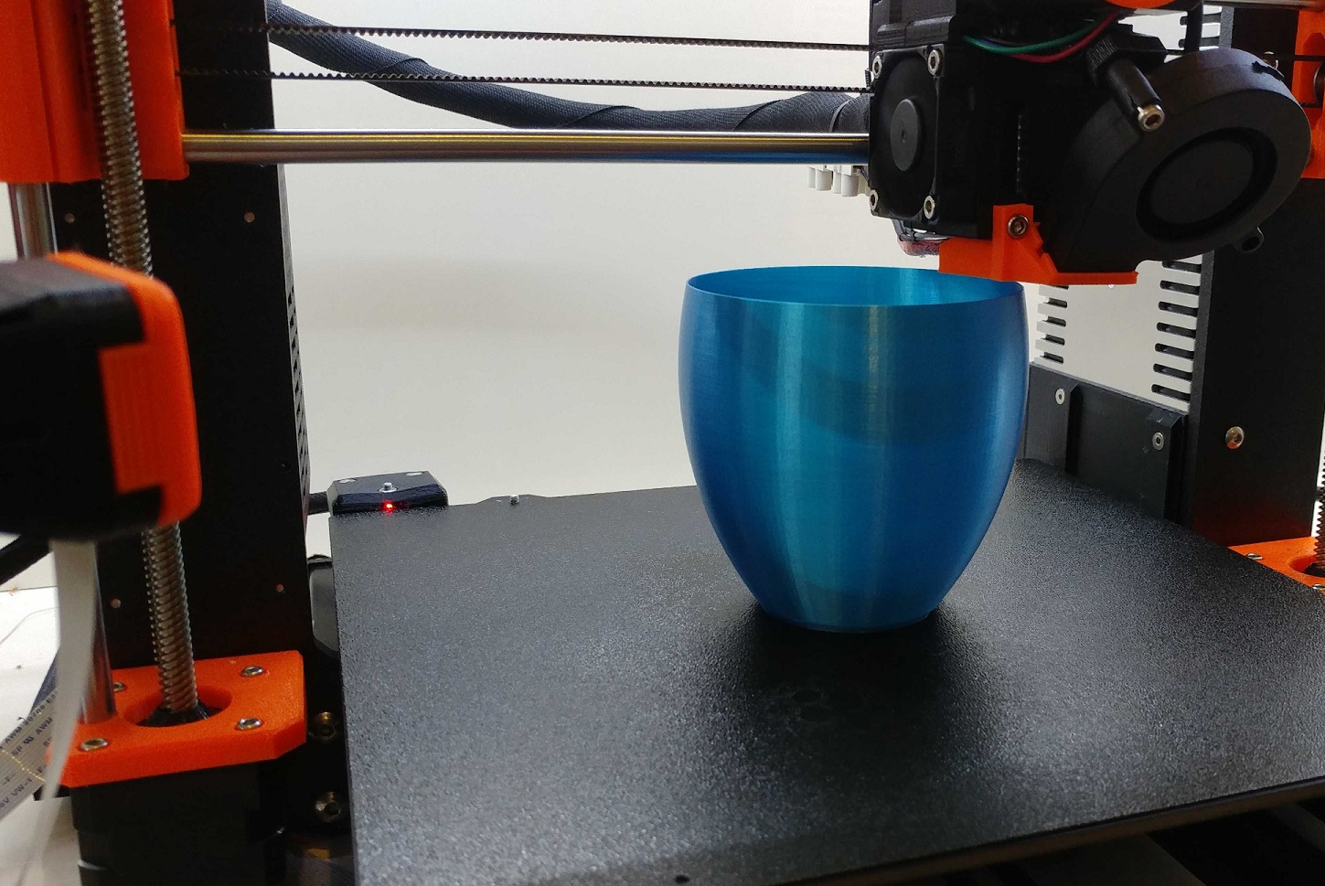

eSun Silk : It really is just PLA but with a "silk" shine to it. Comes in a range of lustres. Just print with std PLA settings. Here is a pic of a cup in Vase Mode. Looks great and was watertight.

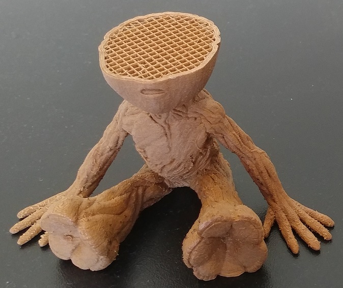

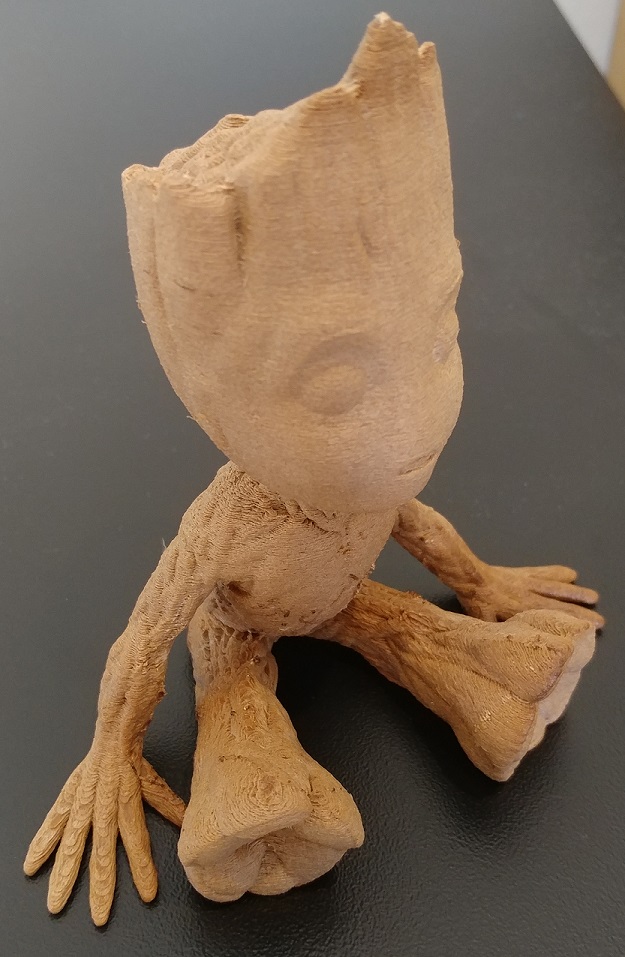

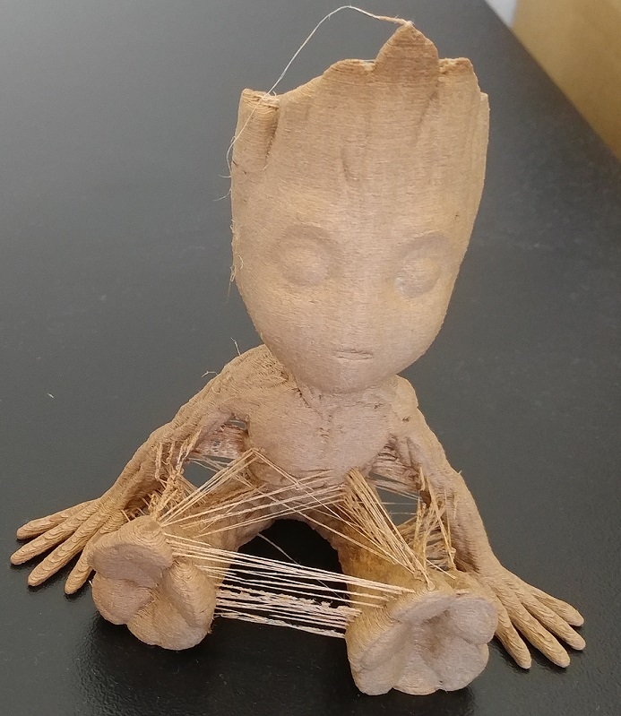

eSun Bamboo : I've printed a few different "wood" filaments without issue, but this one was a bit trickier as it kept clogging. In the end, I had to step up to a 0.60 nozzle, increase layer height to 0.2, print temp +10c, turn off retraction, turn on coasting etc. I also went through a bit of cleaning filamament to try to get all the carbonised muck out between prints.
The following are pics of a Fail (almost made it!) with a 0.40nozzle and 0.15 layer height and the final result before and after clean up. It is stringer than usual PLA, but cleans up ok. It has a nice textured wood(ish) feel to it.
