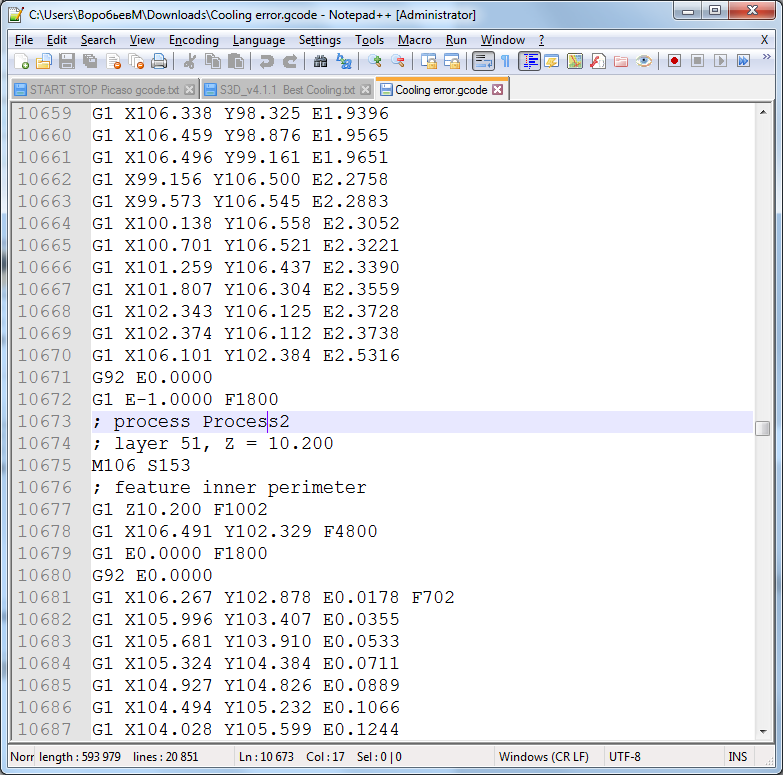

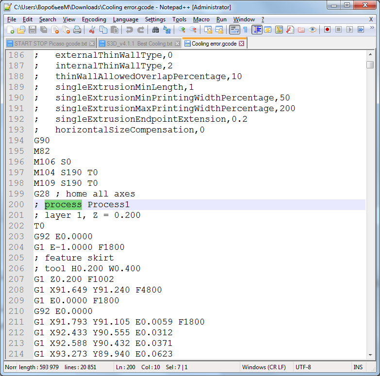

Whats now the matter? Your 2nd picture shows the G-Code for a 2nd process and the M-code-command "M106 S 153".
If that is NOT RIGHT, where this command line is comming from?
If that IS RIGHT, what you have to reclaim?

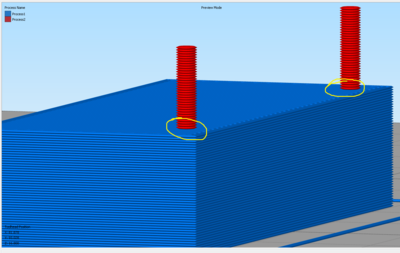

My case is as follows:
Small cylinders attached to a massive base. Cylinders require cooling. The base of the cylinder must be firmly attached to the base. The first 1-2 layers cool off from the interaction with the base. Their cooling is turned off for reliable gluing.
 In this and similar cases, I used a similar method in order not to create an extra process.
