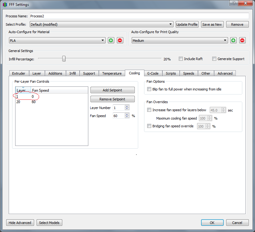

We have two processes.
The first process: cooling 40%.
The second process: from 1 to 20 layers - 0%, after 20 layers 60%.
But in .gcode, in the second process, cooling is set to 60% from the first layer. The initial setting of 0% cooling is ignored.

minvo
Posts: 8
Joined: Fri Jun 22, 2018 8:25 am
Re: v4.1.1 Error. Cooling and Processes.
horst.w wrote: Mon Apr 01, 2019 1:37 pm Your factory and your GCode are not corresponding to what you have written. ...
You are not right. I downloaded my files and checked. Everything fits my description. An error is present.
(If the attached .factory is run in S3D v4.0.1, the result is correct - there is no cooling at the beginning of the second process.)

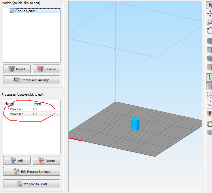

How ever,
I have opened your factory-file and there was only one process.
Whats now the matter? Your 2nd picture shows the G-Code for a 2nd process and the M-code-command "M106 S 153".
If that is NOT RIGHT, where this command line is comming from?
If that IS RIGHT, what you have to reclaim?

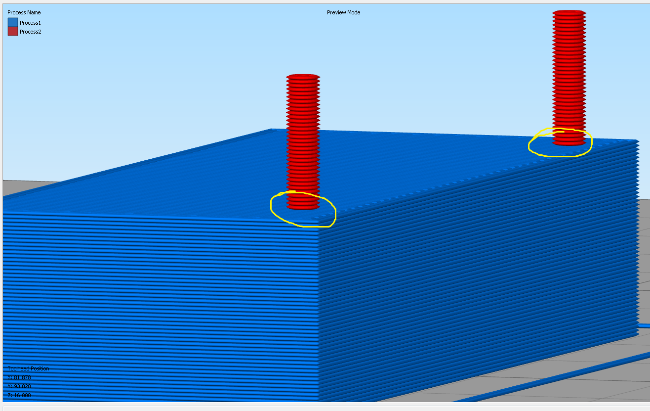

My case is as follows:
Small cylinders attached to a massive base. Cylinders require cooling. The base of the cylinder must be firmly attached to the base. The first 1-2 layers cool off from the interaction with the base. Their cooling is turned off for reliable gluing.
 In this and similar cases, I used a similar method in order not to create an extra process.
