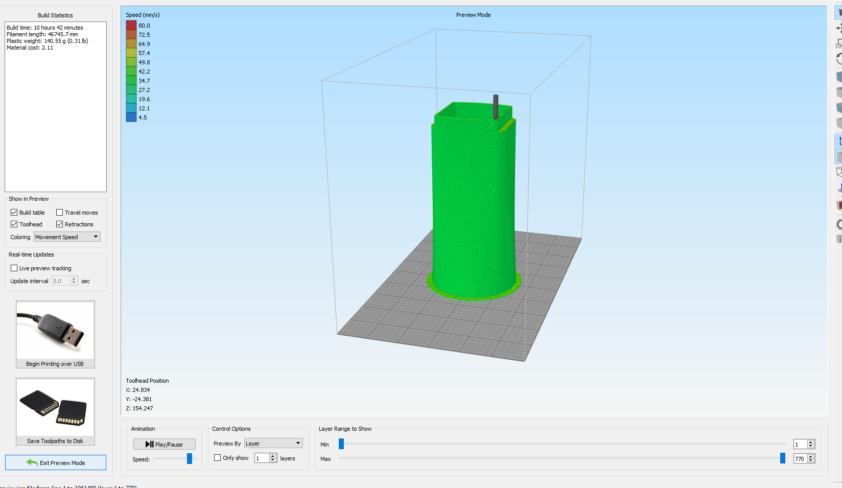

Image 1 shows the model sliced inside S3D.

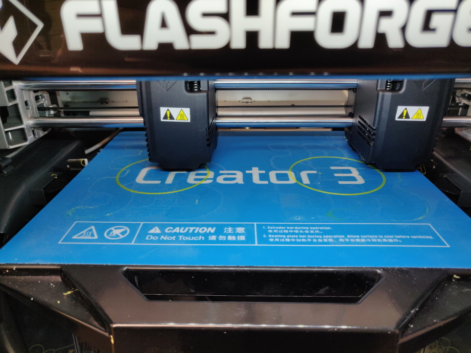

Image 2 shows the gcode viewed by flashprint.

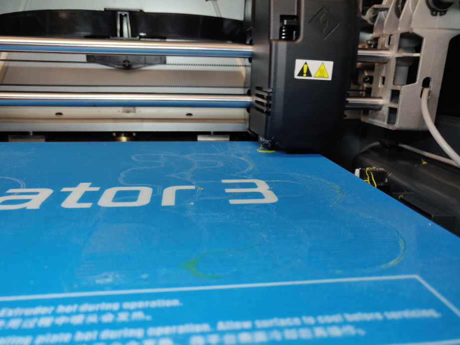

Image 3 shows the calibration pad being made.

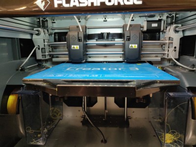

Image 4 shows both nozzles getting into position.

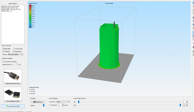

Image 5 shows the model being printed correctly with both nozzles having half the build plate each.

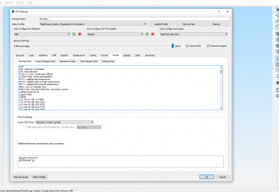

Image 6 shows what you should be able to see in the starting script and additional commands.

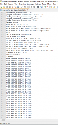

Image 7 shows the gcode file with the included calpad gcode included from the profile.
This is all done using the attached version 2 profile.
The software does not show the calpad being made. Not sure why although it does work fine.
If you use the profile and you are having results different from the images then please send over a gcode file and I will see if something is missing.
