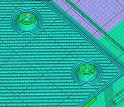

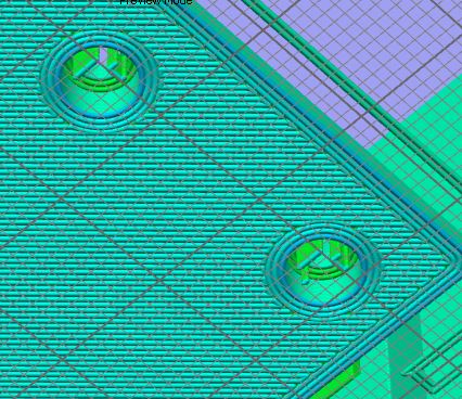

...…..I removed the automatic supports from fours holes. They don't show up in Preview mode,
Well they do for me......

You didn't add any.....and neither did I.
