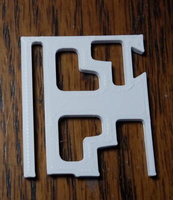

Thanks! I don't think getting the first layer down is the issue, but I went to take a picture of the bottom, and I made a discovery (or two...).
Here's what the bottom of the print looks like:
The filament looks like it's sticking down OK, but what I noticed is that the underextrusion & gap are occurring immediately after the start of the 2nd perimeter pass!
I went into Preview, flipped the model over, and examined the same area:
Gaps Previewed From Below.jpg (18.57 KiB) Viewed 13914 times
The first perimeter occurs normally, with the nozzle going counterclockwise around the opening. At the end, it jumps right and begins the 2nd perimeter. There is a retraction at the start of the 2nd pass, but it's acting like it isn't "unretracting" when it starts printing again, and the nozzle is starved for filament for a significant distance. The third pass starts in the same fashion, and may also be starved for filament.
Not sure what exactly what this means or how to fix it, but the gaps are occurring because the extruder isn't pushing enough filament out once it starts the second (and probably 3rd) perimeter.

airscapes
Posts: 403
Re: Gaps in Perimeters (Again)
This makes prefect sense and why I did not include any of the unnecessary retraction setting you have when I posted the first factory file .. No lift no restart no wipe no force no avoid etc
Just finished my 4th print of your factory and set all there retraction as I normally have it and there are no gaps to speak of. Couple more little changes and will post the file. I ask that you load the file and print without making any changes to it.

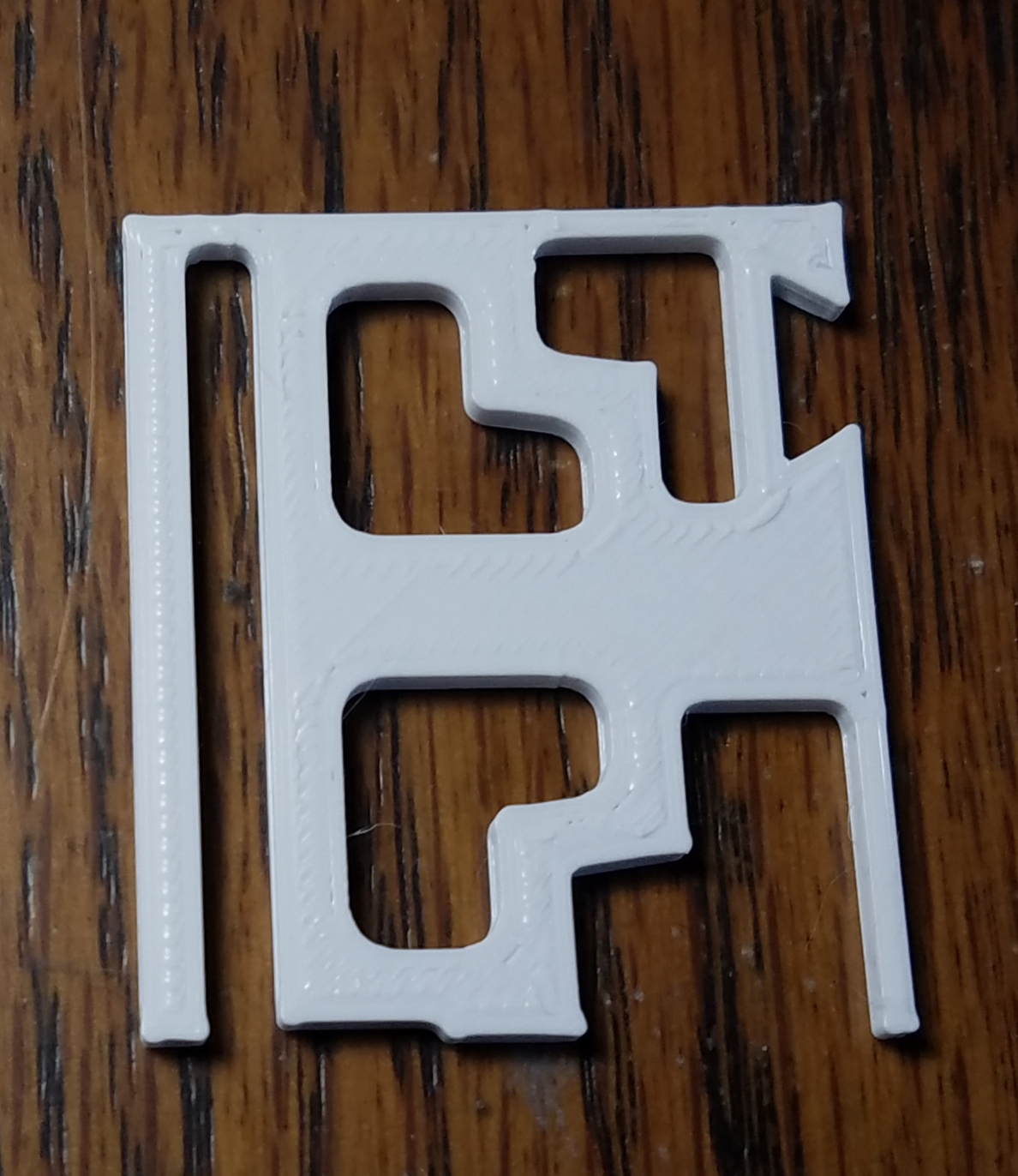

Posts: 403
The attached factory file was used to print the part in the attached image. Please load and print without changing anything and see if you gaps are gone. I would consider this part perfectly acceptable, this is FFF and it is far from perfect. The more we try and make it so the more issues we create. The makergear printers are very accurate they don't need a lot of software tweaks to do good work..
