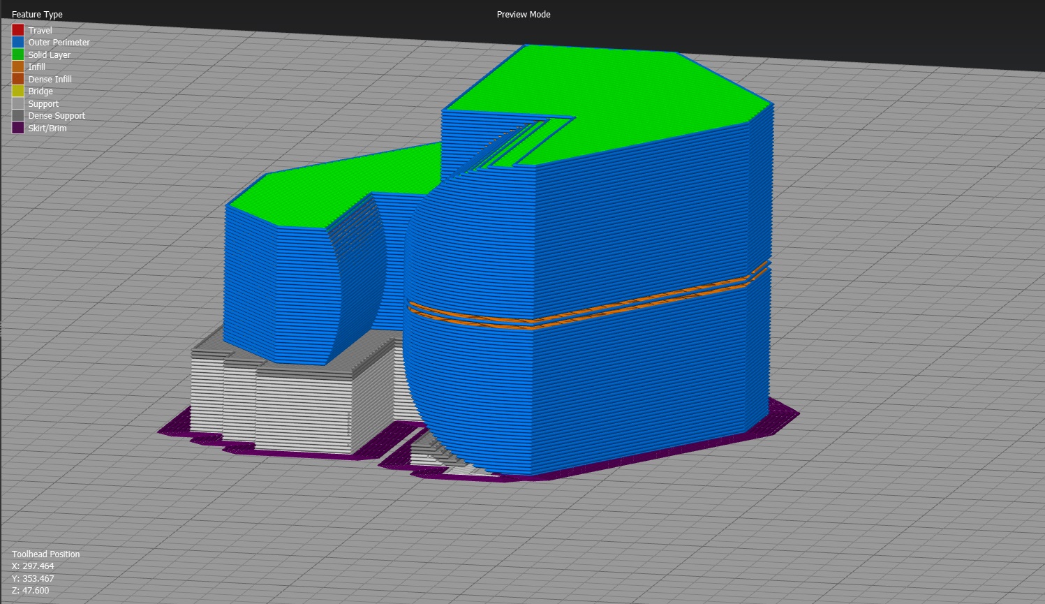

Hello Everyone!
I am trying to print a simple component with my Modix Big 60, with a profile that I've been succesfully using for almost two years now.
There is a very interesting error however in the slicer preview.
I suspect there is something wrong wth the STL, but at the time I don't have the analytic geometry. Print requestor will send it to me later, but in the meantime, what do you think might cause this? I've never seen a skip like this.
I tried adjusting perimeter line width and count, layer height and infill though admittedly I didn't try for too long. I have also not tried sending the gcode to see what happens.
Thanks,
M

This looks like a mesh related issue.
I've tried these two options and both worked:
1. Mesh > Separate Connected Surfaces, then slice again.
2. OR select 'Alternating Fill' for the Slicing Region Repair Mode (Advanced tab-> Slicing Behavior).
You can read more about it here:https://www.simplify3d.com/resources/ar ... sh-errors/

Hello, and sorry for the very late reply.
It was indeed a mesh issue, I have taken the object and remodeled it in an analytic geometry sofware, then exported the tesselated body from there again. It worked.
