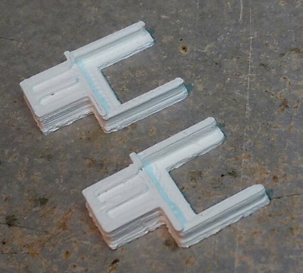

Just bought S3D and started playing. Saw this thread and figured I'd give these settings a shot... Not as bad as I expected! Everything moved so fast, I didn't thing there was a chance of decent results. Would be cool to see these translated to the latest version (there were some numbers that really didn't line up).
Top part is pretty much the default (lowered extruder temp by 10°). The other is with the settings noted above.
This is a small part (1" x 0.75"), so, keep that in mind. Also, the infamous, white filament. :lol:
