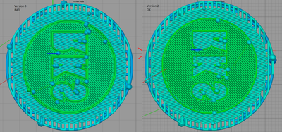

Doug, thanks for the effort in your long posts. Thing is I remove rafts about 3 or 4 times a day because I have UP printers here and sometimes there is excessive adhesion due to running a filament too hot, too slow, building up too much heat in the raft or an unlevel bed. To get these print off safely I have techniques to help the raft shear away leaving minimal raft behind to clean up.
What I am seeing with Simplify3D is something different because I am getting adhesion at the edges in one axis and the edhesion is extreme - those are not remnants that are a little bit stickier but the adhesion on those raft edges is actually greater than the final part layer to layer adhesion. It is a very strong mechanical bond.
Don't be too distract by the ring print. I use it to test because it doesn't consume too much filament and the final part is useful because it's a lower tolerance part. This issue happens on every print without fail.
I have:
- gone up to 7 layers of raft
- disable raft base layers
- obsessively levelled the bed (people usualy get me to level their beds for them because I do such a good job) - though this is usually clear because in such cases the raft tends to be stuck more on one side.
- played with the inital layer height from smooshed right onto the bed nearly to the point of nearly jamming (missing a step or two) to barely sticky to the bed due to it being at nearly 100% layer height.
Everything yields essentially the same result just in greater degrees i.e. some are completely impossible to remove ... to the best example in the picture above.
As to your theory, the raft is actually peeling best where it is in the same direction as the raft and worst where is is at nearly 90degrees ... this is the opposite of what should be observed ... at 90 it should bond less and aligned is should bond more. Further it is not worst at 90 ... it is worst near 90 specifically about 75degrees. This curios angle really doesn't lend itself to making any sense. That said I'll take a look at more angles to see if there is correlation.

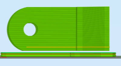

roller wrote:One more thing. In my common test print you can see that in some areas the raft does remove acceptably (shown in the image in cyan) but in other areas it is very strongly adhered to the print layer (yellow). Separation distance is 0.25mm on this example which is printed with a 0.2mm layer height.

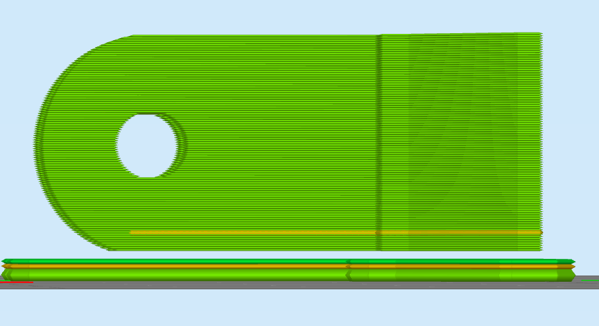

I scale my rafts to be 1 complete layer of separation - 0.25mm layer height 0.25mm separation.
I then preview the raft before printing to make sure the layer is there. When you added excessive separation to the prints were you able to see a significant gap in the preview?
See the screen shot for "excessive separation" of 1mm which should really just create a big mess but the raft would be easy to remove.
A raft shouldn't just fall away from the print which I'm sure you know. But the nice solid 3 layer raft can easily be removed in one consistent piece with minimal effort.
Separation 1mm
Separation 1mm

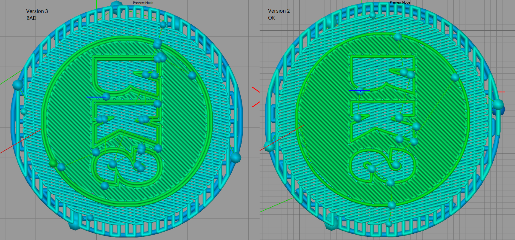

It was no problem at all with 0,14 separation in V2. The raft angle goes the other way in V3 wich makes it difficult. Since they also managed to take away the possability to control the solid infill angle in V3 :( , there is nothing else but to go down to a minimum of temp for the first bottom layer. I go down to 190.
