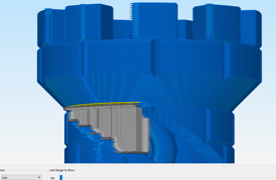

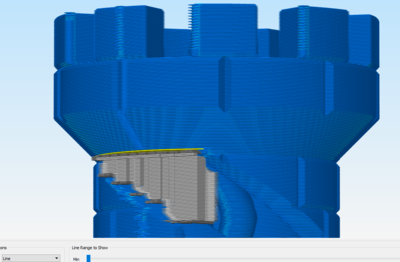

BUMP - I just ran into this problem also and I think I figured out why it's happening. Printing an object with supports set and combine every (2). Also have dense supports at 2 layers. I think it's not printing when the dense supports fall in-between the combined support value and it cannot combine the (2) dense supports into one layer (combined) without violating the stay (1) layer away from the surface parameter. (I'm assuming here trying to test to find what causes this to be ignored). If I turn off combine every(2) the dense supports work fine just as noted above. Still testing but have turned off combine so I can print.
ceondraka
Posts: 17
Joined: Tue Jul 09, 2019 12:58 pm
Re: missing dense support when combining every 2nd layer
SOLUTION:
OK attached is my factory for this part and if you do the following you can see where the issue is and why its happening.
ASSUMPTION: Combine support layers applies to both regular and dense (it looks like it from the simulator)
ISSUE: Open the Factory file and review. With combine supports every layer set to 2 you will see the following:
Supports are filled in on the even layers with the last one completed on layer 36 and no dense supports are printed so the gap from the last support to the print is 4 layers. Print is on layer 41. So if you combine and leave the (1) gap it has to end by 39. Can't happen there is a conflict. I have dense set to 2 and if you subtract that from 39 you would have to start at 37 which is not where the next combine level would be (it's actually 38).
DISCOVERY: Change combine every layer to 1 and repeat
Supports are filled in on every layer with the last support at 37 and the first dense layer is at 38, second dense layer is 39 and layer 40 is the open gap and the print is on layer 41.
So you can deduce from the calculation the software is trying to do the next combined (2) layer at 38 when the dense is also supposed to start on that layer at the same time. Conflict with both trying to print, so neither is printed......
FIX: You can easily correct by adding/subtracting 1 from the support base layers to change the combine layer to offset it. This removes the conflict.
