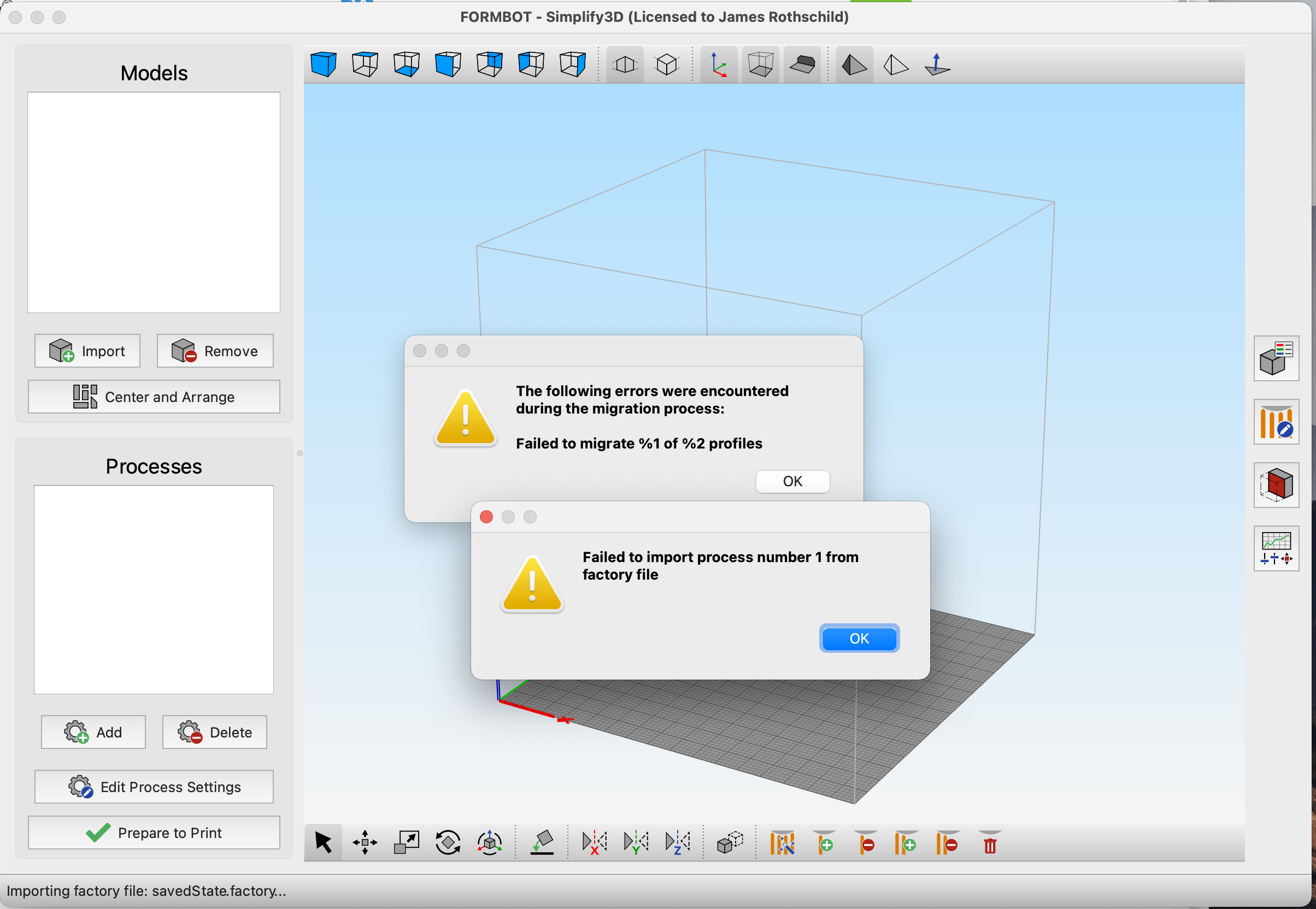

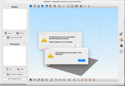

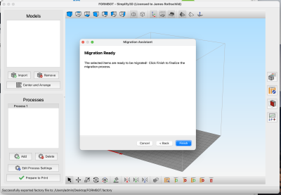

Getting constant error trying to Migrate settings from S3D v 4.1.2 to v 5
Also cannot open v4.1.2 .factory files with v5
- MacOS Ventura 13.1.x on MacBook Pro 16", M1 Pro, 32Gb.

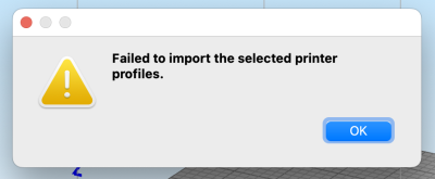

I also attach one fff file example, can you advise that is wrong with that profile please, as I cannot import even a single fff file into v5 at the moment :-(
Thank you.

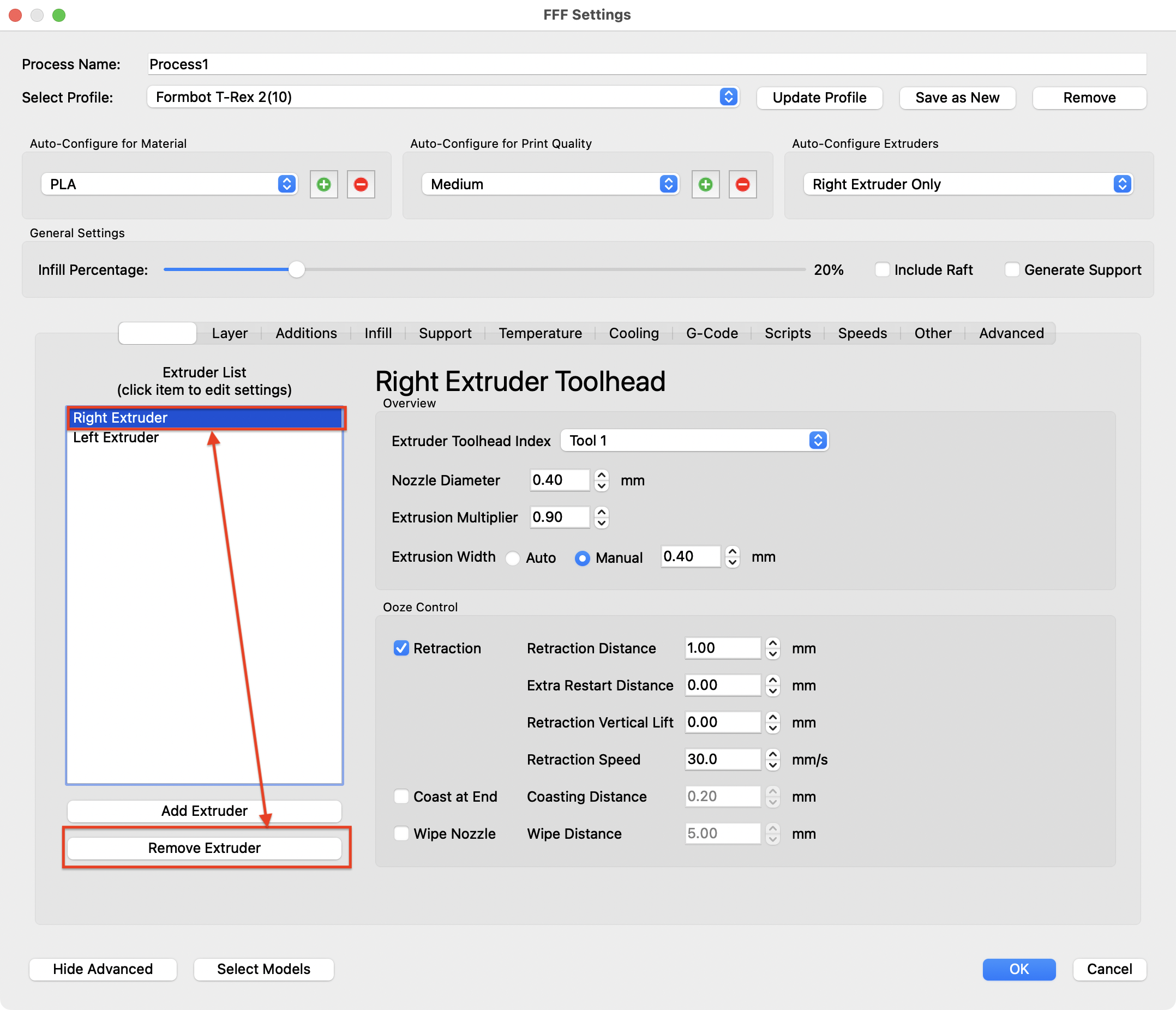

Just to let you know...

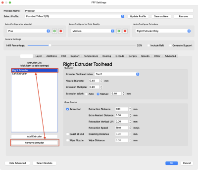

I usually delete the Right Extruder within the Simplify3D application.
I have never hand-edit an XML file, and then reimported it.

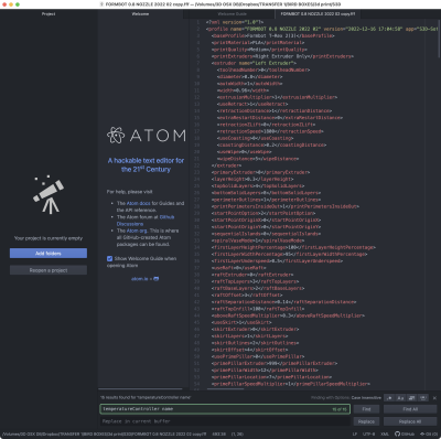

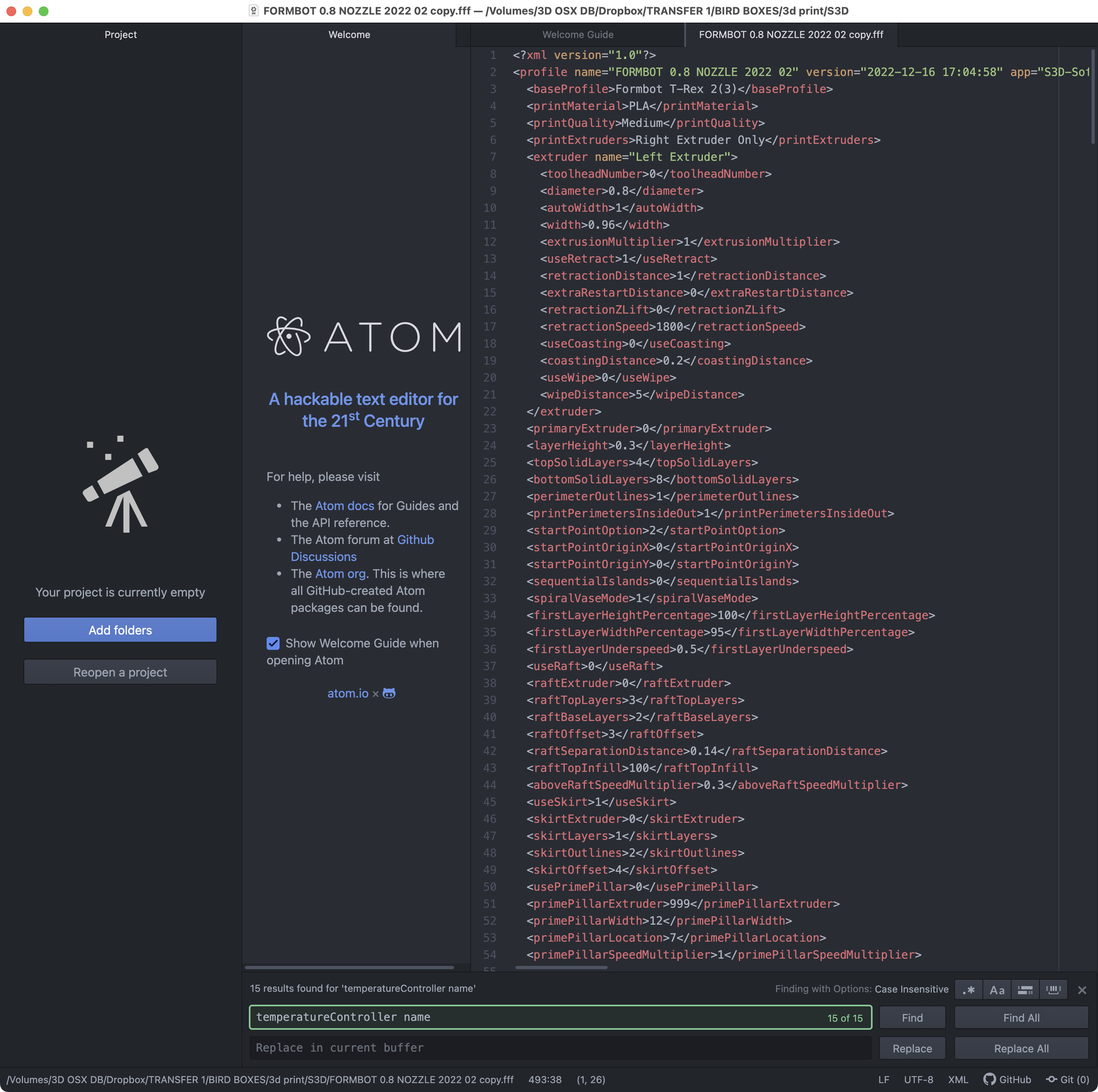

so, I have open up the XML fff file in a text editor and can find no errors as your suggest ...

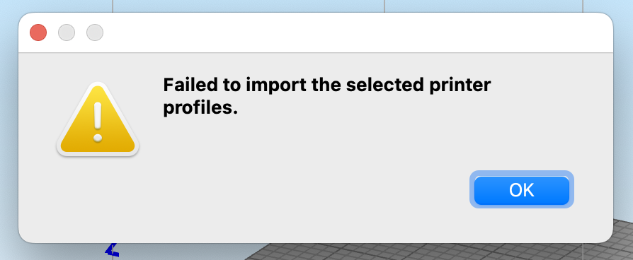

I have the same problem, I exported printer profiles from 4.1.2 (for a non-supported printer, being Felix Pro 3 Touch).
I tried to import the exported profile (no hand editing done, just a clean export from 4.1.2 and import in 5) and I got the same error message.
I'm using a Mac-Studio with an M1 Max chipset
(attached: failling .fff file)
Edit: Problem solved with the assistance of S3D: nested autoquality items in automaterial statements. After removing the nested items, putting them one level higher in the xml-file the profile could be imported without any problem.
