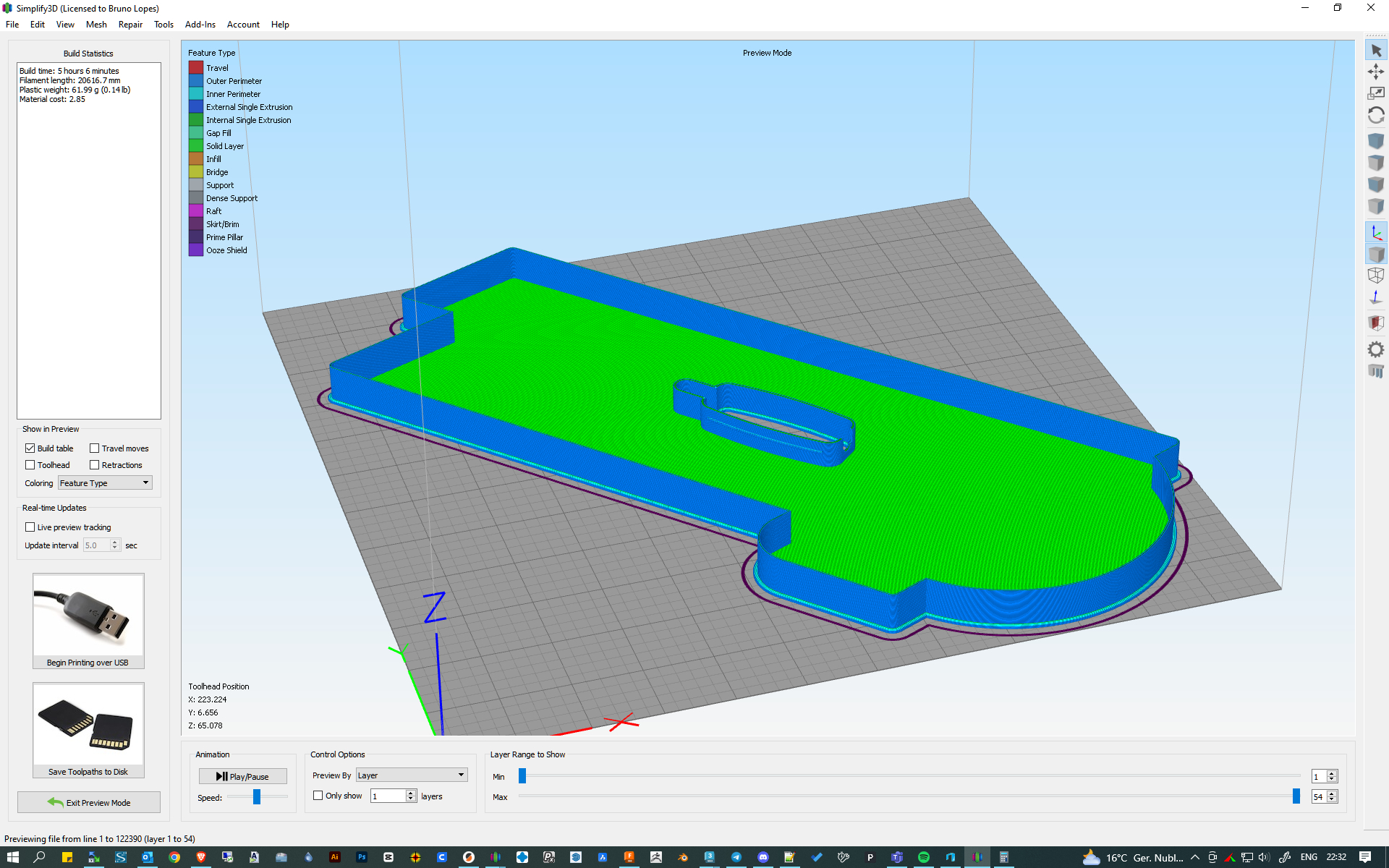

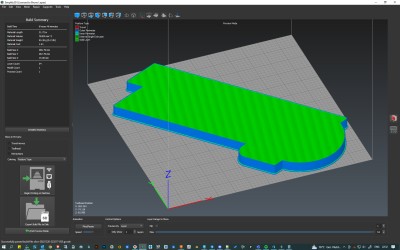

Anyone has a explanation to this...?!?!?!?!?
In S3D v4, working as expected, but in S3D v5, does this?

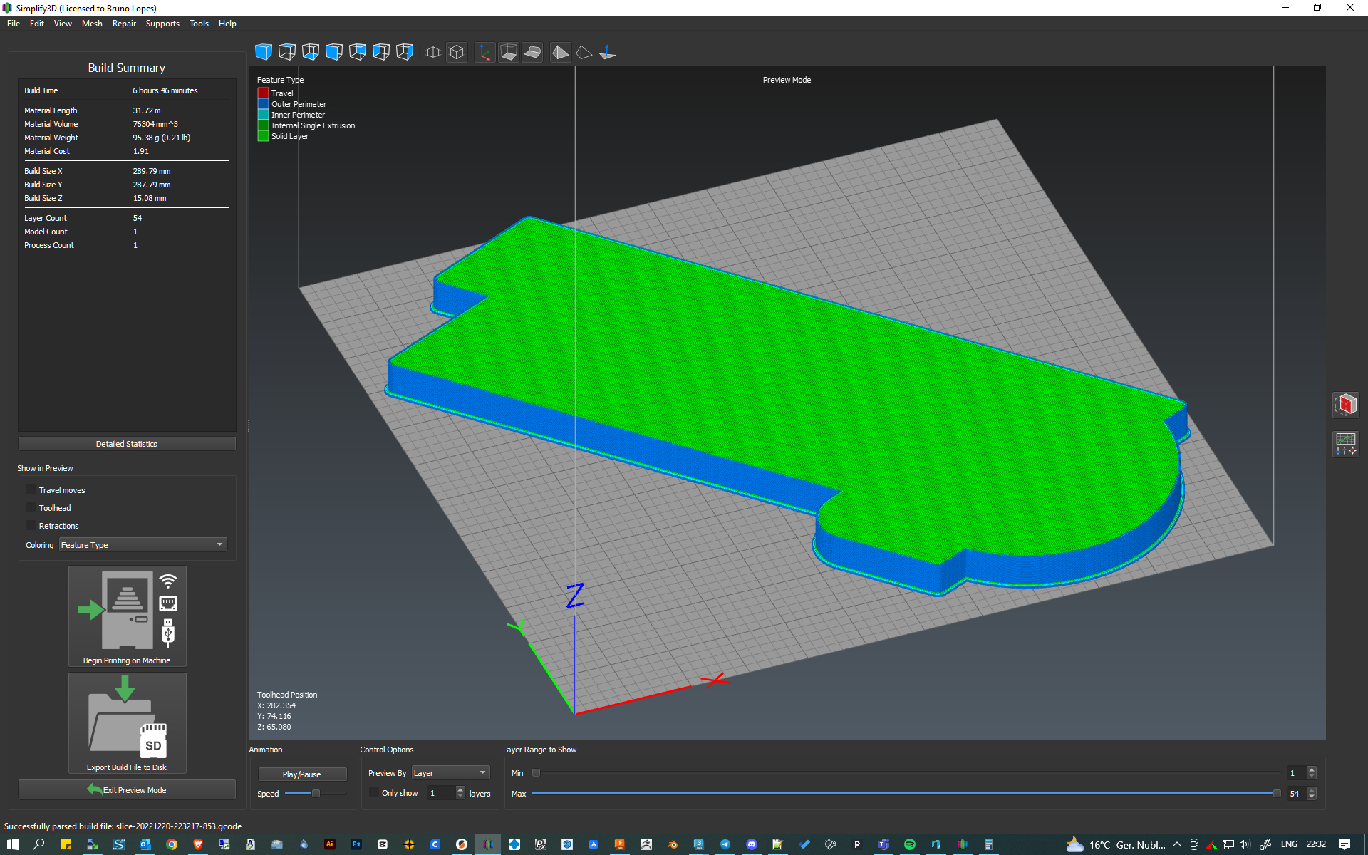

Yes...for some reason...now is slicing correctly...but with this one is doing it again. Attached

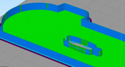

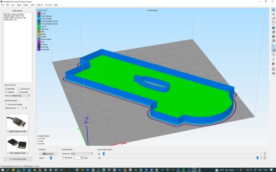

S3D-Jason wrote: Tue Dec 20, 2022 6:21 pm Are you able to share the factory file?

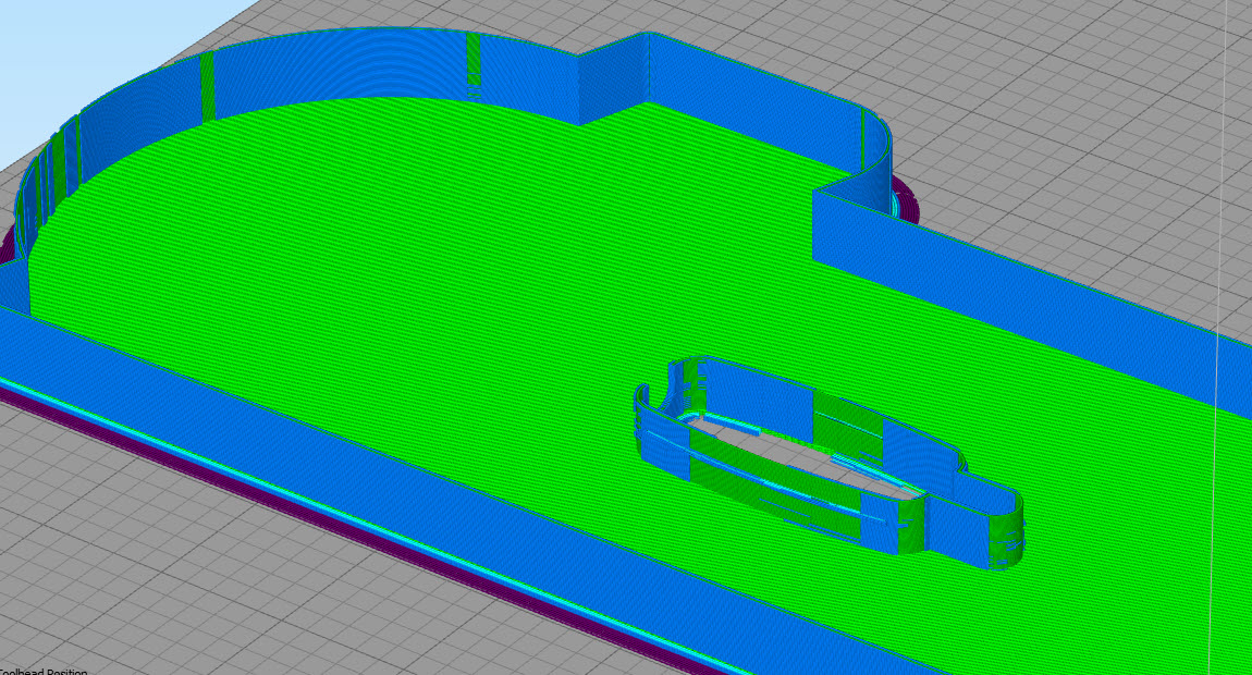

I was working on this part also. I can fix the top being filled in by changing the layer height from 0.2000 to 0.2001. Seen this before once in a while.
However, the sidewalls are bad, see picture.
On this if I remove G90 OR uncheck "use relative extrusion distances" the side walls are ok. I should not have to do that though.
I can load this model on another printer and it is fine.
This all works fine in V4.

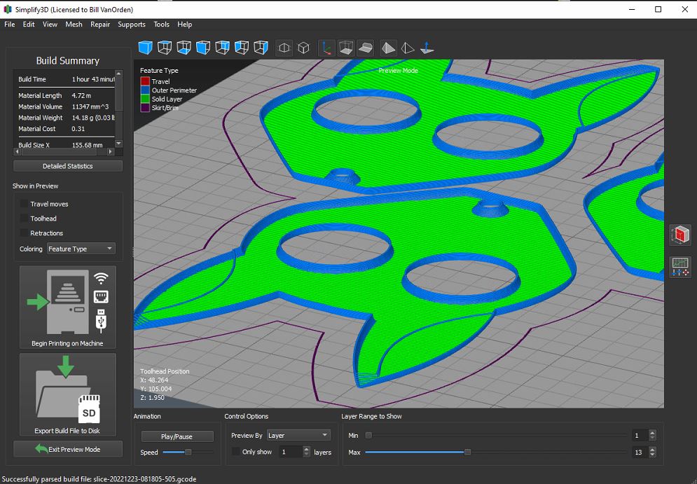

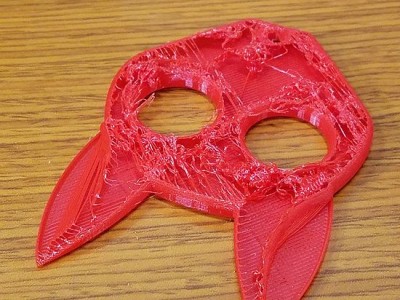

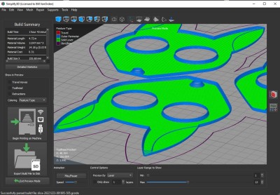

Re: Part being filled in

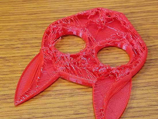

I am seeing the exact same issue. Parts previously printed with version 4 are now hollow!
I looked through the setting but can't see anything to change to cure this.
