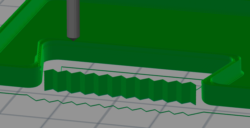

For the attached stl file: when sliced, a part of the model is missing (it's very thin support material that I put in manually). Also attached is the process profile file. (i think that the files are attached - phpBB doesn't really give much feedback in that regard).
EDIT: seems that stuff doesn't post here, which is a drag. Find files at https://www.dropbox.com/sh/760qxh1dumt8bi5/9Q7m7DV5C8 - contains a couple of screen grabs, the profile file, and an STL.

So I did some analysis on the STL and I think I at least have the reason for the missing feature nailed down. Let me make a few general suggestions first, just to help others that might be learning.
Anytime you have issues with a model, the first thing I would do is go to Repair > Identify Non-Manifold Edges. This will analyze the model for any incorrectly formed elements that may cause issues with the slicer. There are also a few tools to help repair problems you might run into, but knowing they exist is the first step. Your model actually checks out fine, so no problem there.

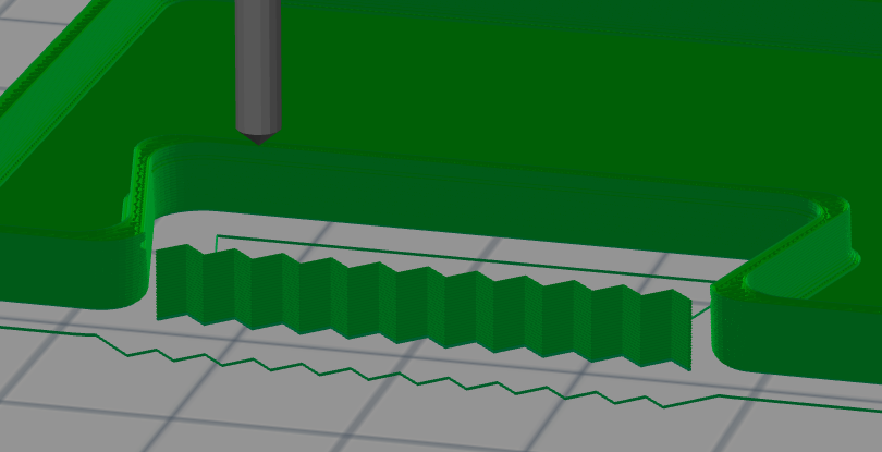

The next thing I did was dig a bit deeper into the actual location where the slicer was having problems. It's clearly a very thin feature, so that can be difficult when you try to represent it with a finite extrusion width. Typically, if the slicer can't outline the region without going outside the bounds of the part, it won't print it. In other words, it will never be able to print a 0.1mm thick wall with 0.3mm wide filament. Just to prove that's what was causing the issue, I went in and decreased the extrusion width slightly so that the very thin feature could now be represented properly (see screenshot).

The thin feature (the support material) was designed for Slic3r's wall width for the model's layer height, at the time, which was .37 mm. It's definitely greater than the nozzle width, but apparently not as wide as Creator's minimum wall width. Changing it to .39mm solves the issue.
