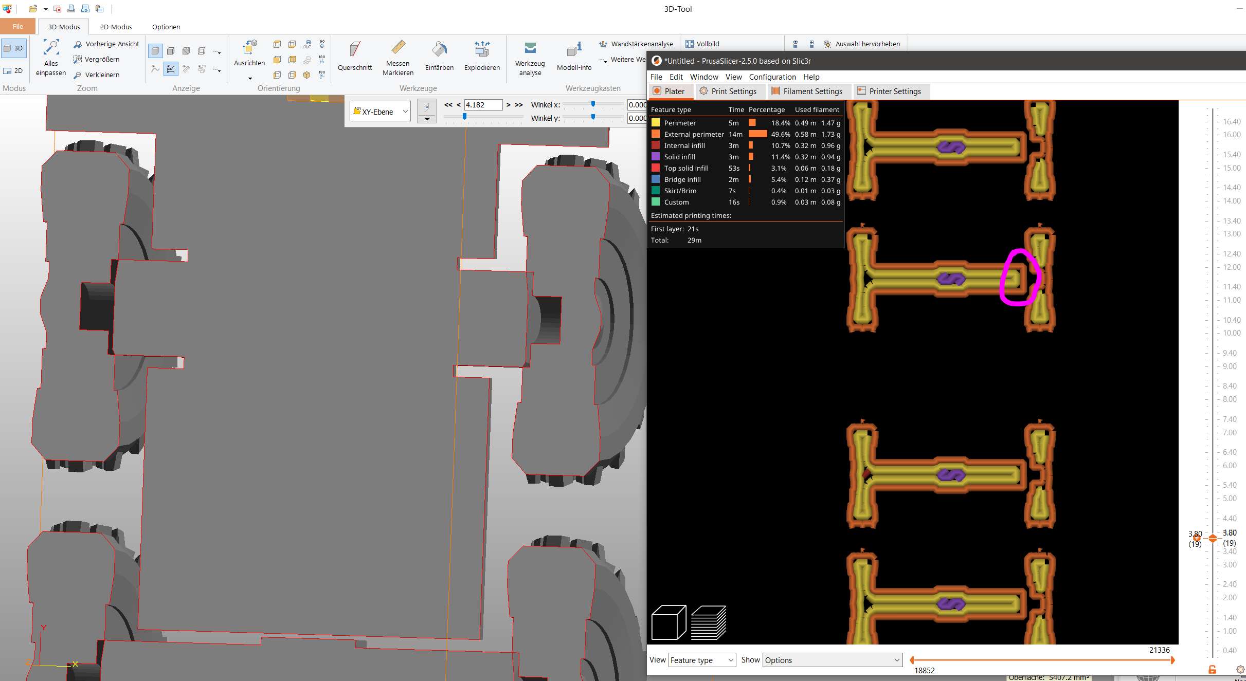

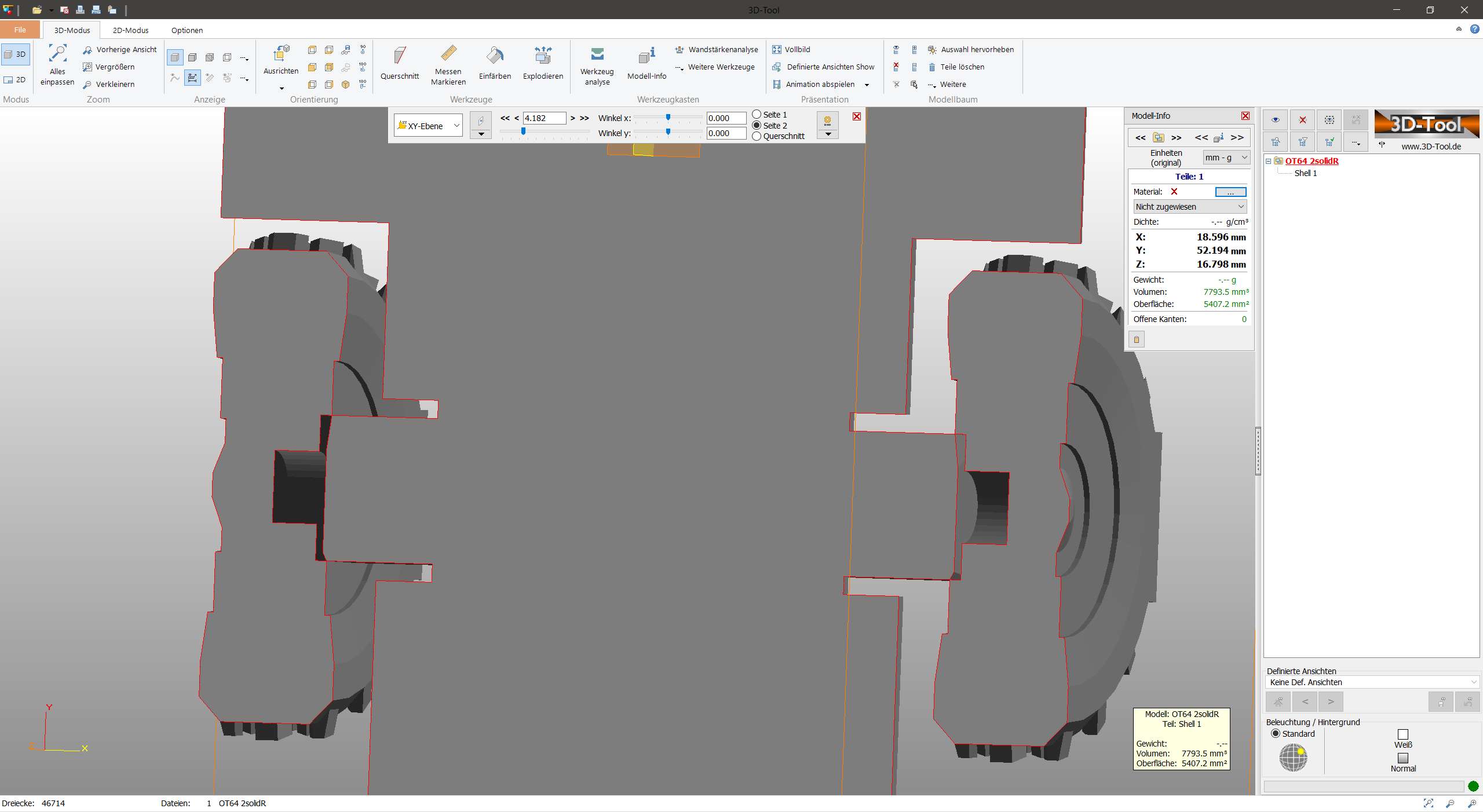

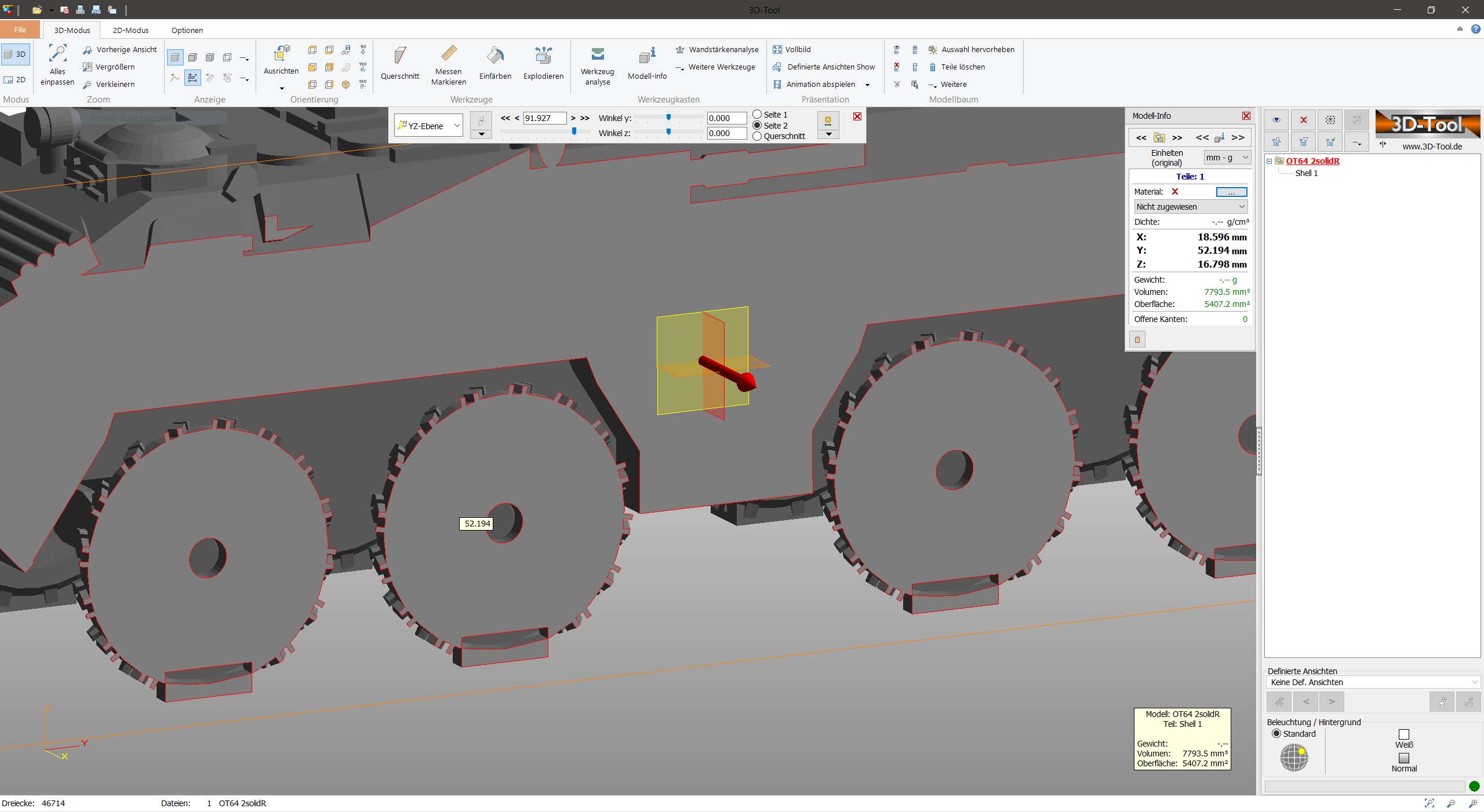

Have a closer look at the cross section, note the blocks in the wheels for example:
The different parts aren't properly merged into one solid, there's lots of walls with 0 thickness. This irritates the slicer a lot, PrusaSlicer
is also having a hard time here... ^^
Those wheels won't properly connect, they're only touching by the outer perimeters. And PS can't find a way to slice it symmetrically like
the mesh really is.
It kinda looks like multiple hollow bodies stuck into each other while it should be one solid volume. If you've merged
the parts you might check the parts before doing so and look for different boolean operations in whatever program you
might have used to merge them.

The corners of the diamonds of the tire tread were touching the straight line of the wheel surface. And apparently that one thing is enough to send TurboCAD into a screaming hissy fit and screw eveything else up. How this translates into confusing Simplify I don't know, but it does.
This is an unfortunate facet of the "upgrade" to TurboCAD version 2021 from version 21; in v21 if it encountered this issue, it would refuse to assemble to part. The v2021 version cheerfully doesn't do that, but pretends it has assembled it anyway when it hasn't basically, making everything an infinitely thin shell. Meaning troubleshooting the meshes is sometimes a tedious case of trial an error.
Unfortunately, in this specific instance, there was no visual clue that it had fracked up (normally, you can spot it by the fact that when you assemble something, you can see it hasn't booleaned it properly) AND that it elected to apparently continue to assemble afterwards.
I have done the usual fix of moving the tire-tread diamonds 0.01mm away from the line, and my initial test does show Simplify is not missing bits now.
