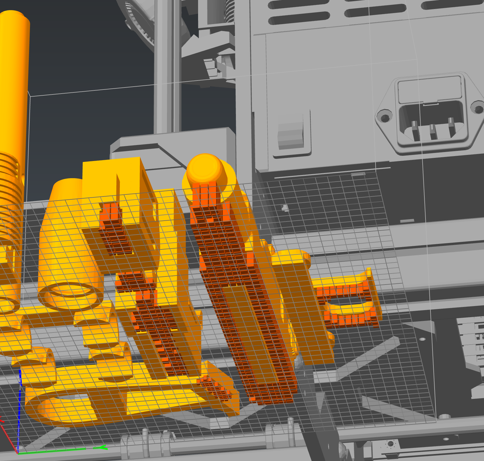

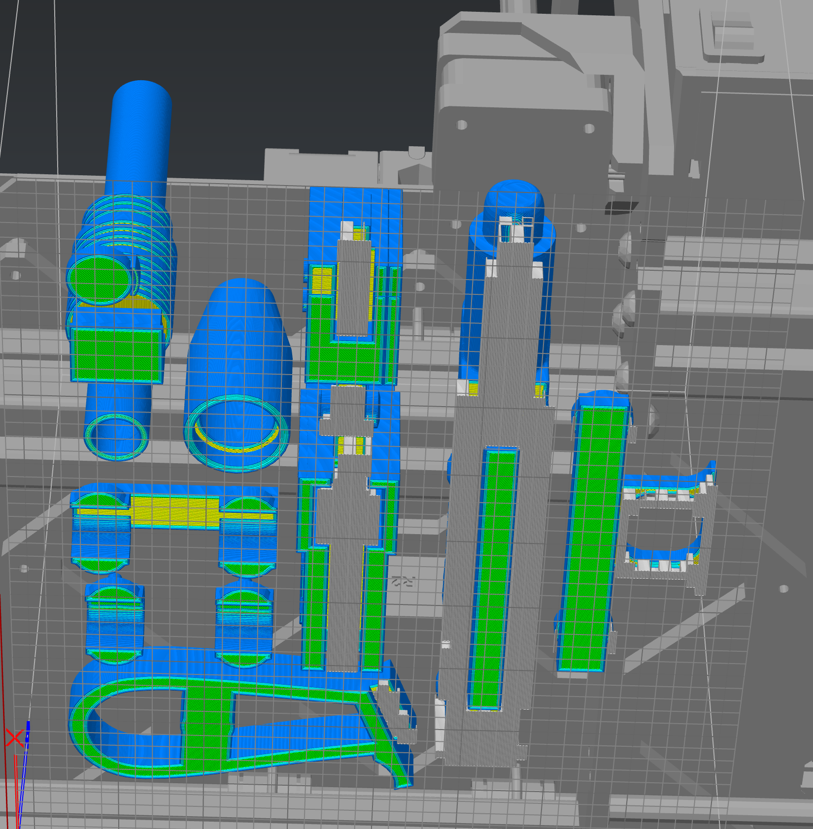

wth?!?! how is this support estimation ends up in supports missing all over?!?

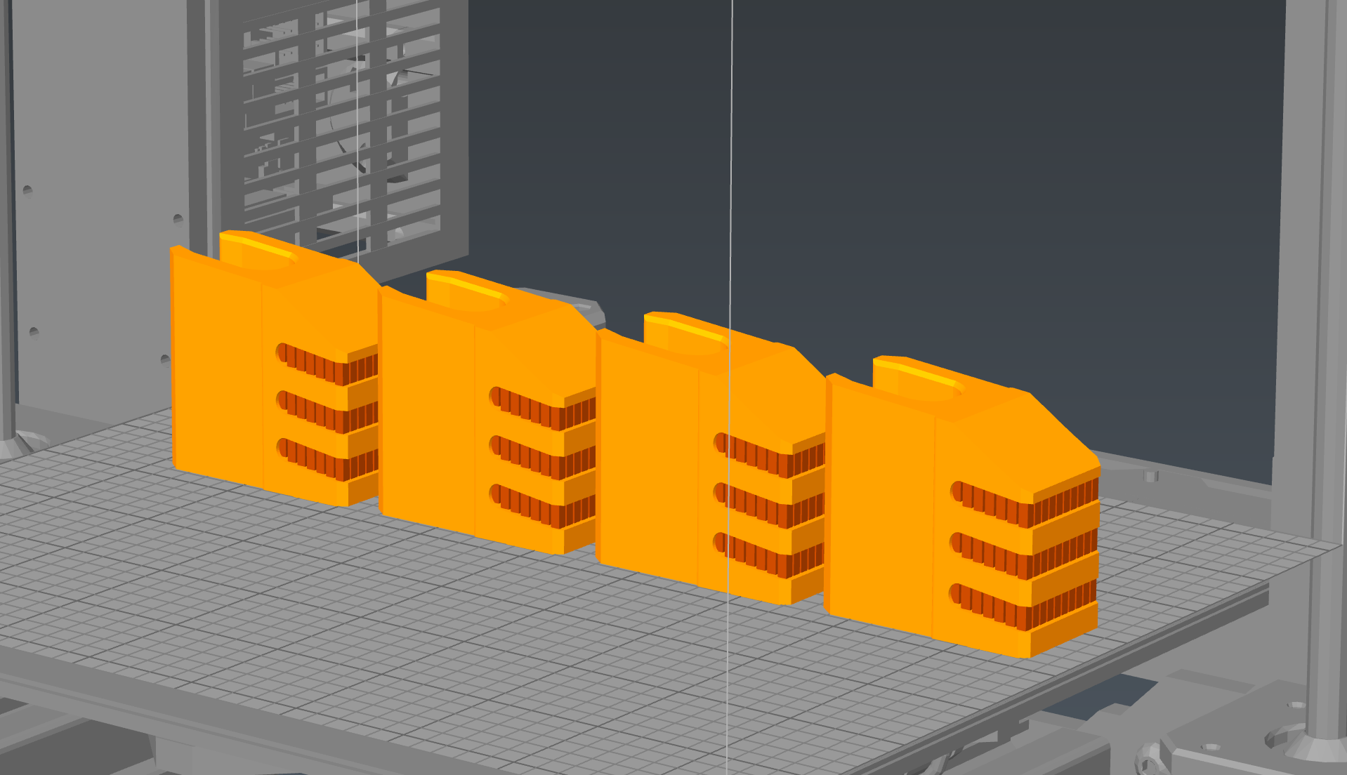

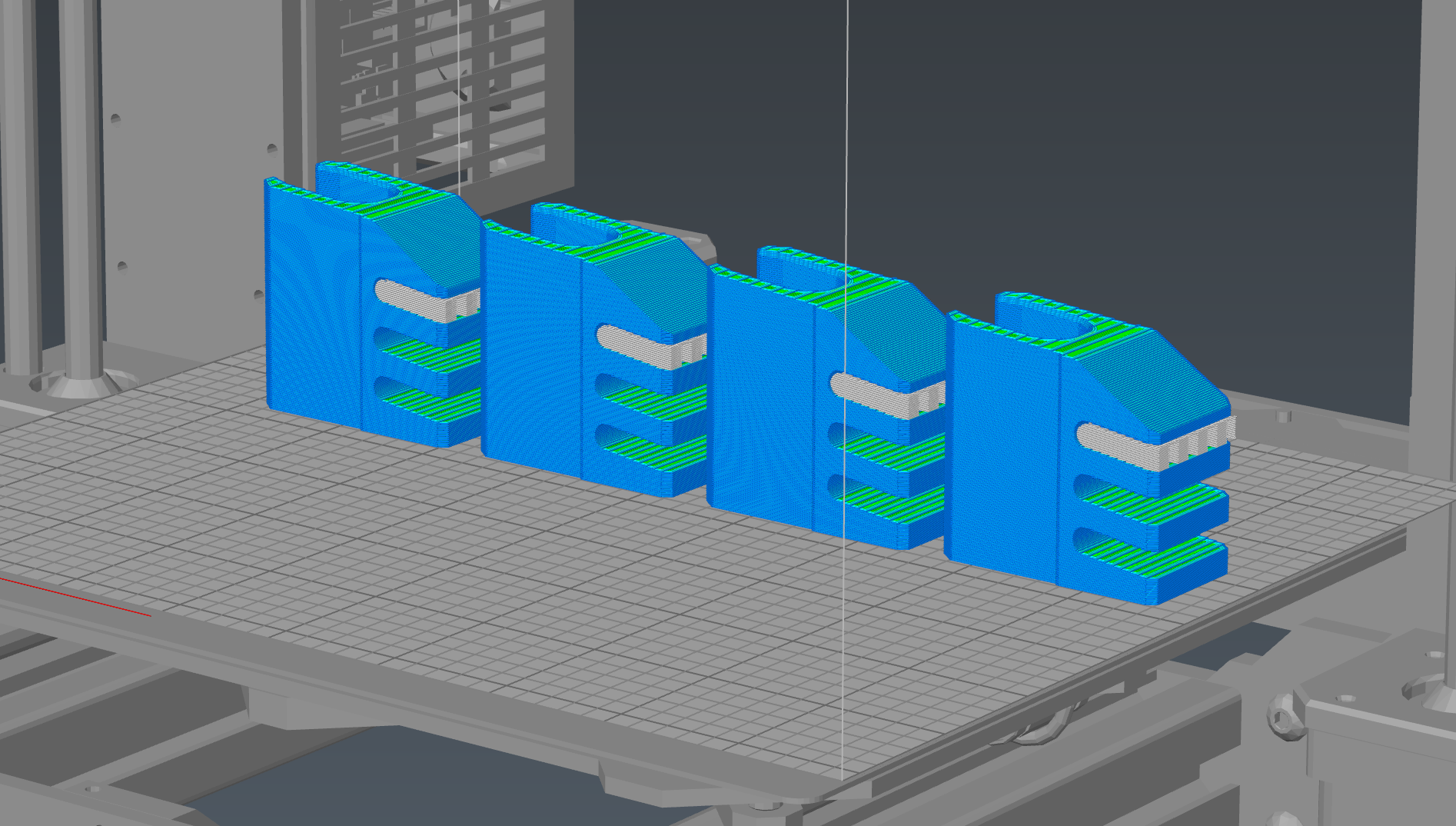

I think I found the issue...

...and the issue is:
since you had the GREAT idea to remove the Enable Support checkbox, now any old factory file (pre 5.0.2) whose supports were already declared will need to be recreated no matter if your latest version does read them in the build view.
GREAT!
:evil:

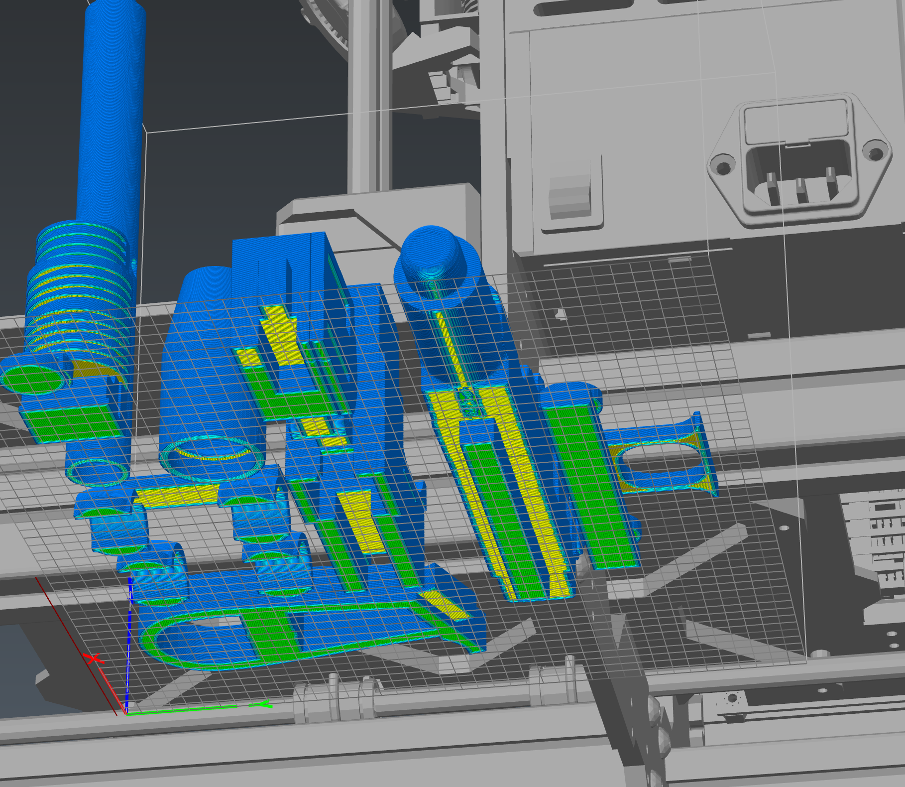

Here, same job as above with the supports recreated, re-deleted where not needed, etc :/
