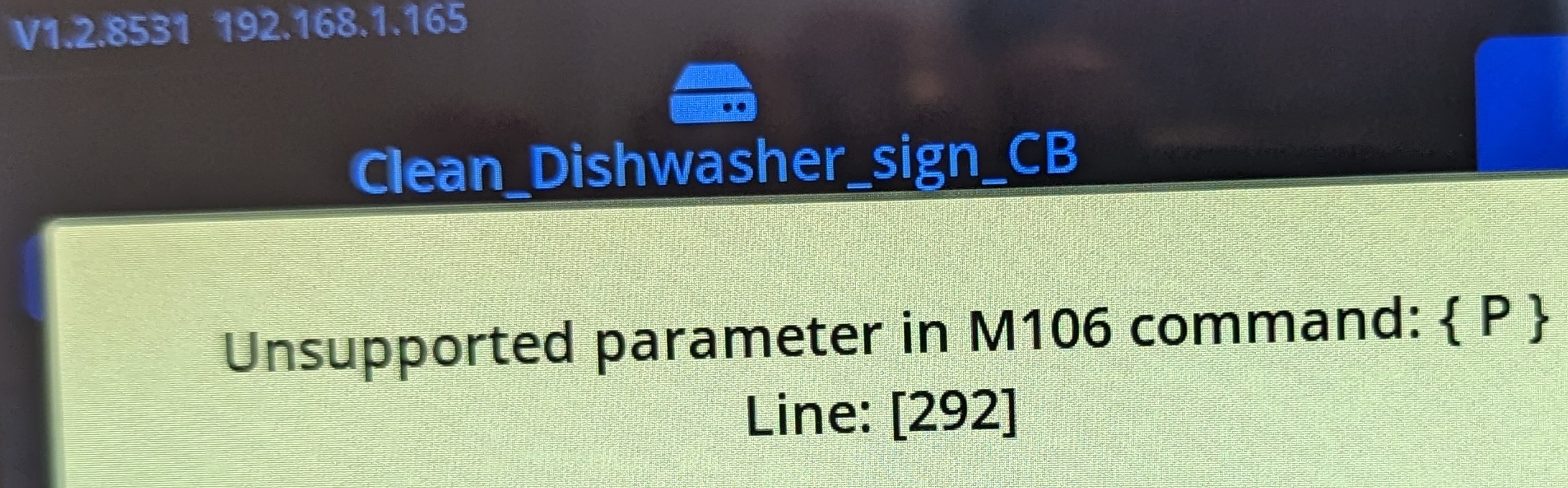

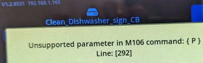

the printer gives an error message: unsupported parameter in M106 command {P}
If I edit the gcode and remove the M106 parameter P0 which appears in 2 places then it prints successfully
How do I prevent S3D from adding this parameter so I don't have to edit the Gcode?
Re: Craftbot IDEX XL M106 error
I think the answer was already posted here:
viewtopic.php?p=63519#p63519
