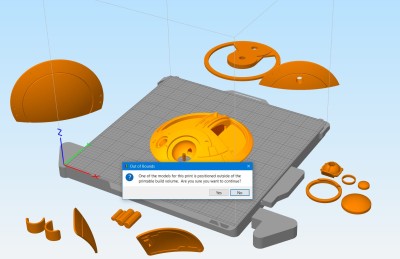

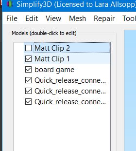

Does anyone know how to get the check boxes back in 5.1.1 or 5.1.2?
I always load all my pieces into a factory file and just put on the bed what I want to print.

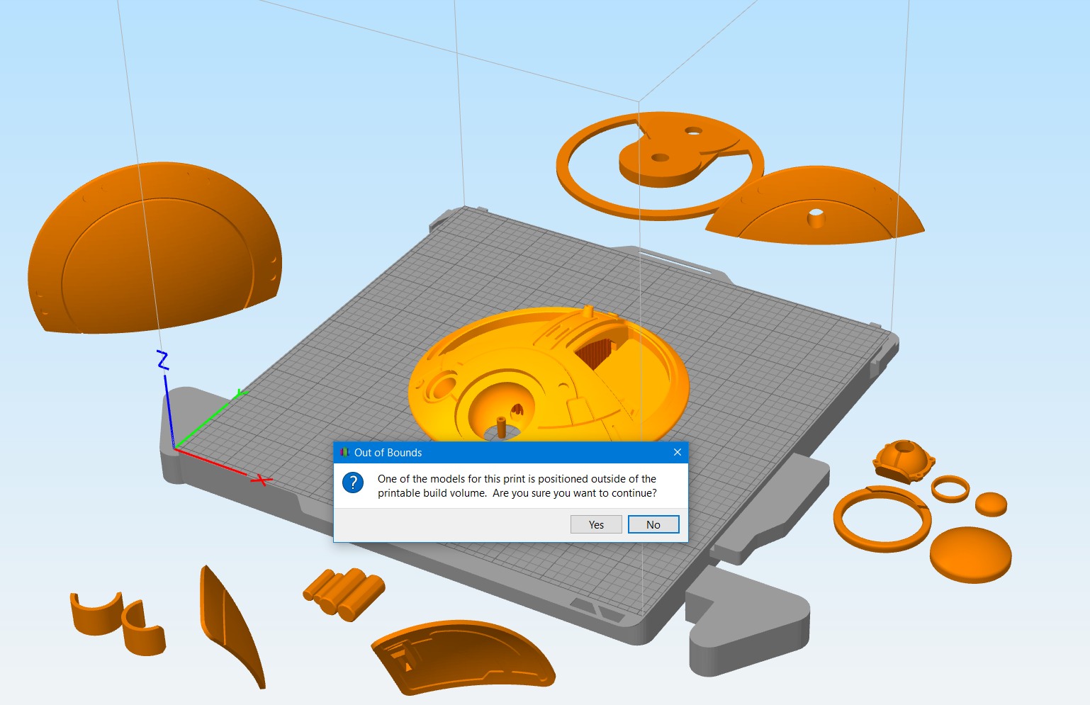

5.1.2 is trying to print ALL the files, not just the ones on the bed but I cannot hide them anymore like I could with 4?
This is 4 with check boxes. 5 has none and gives warning and I cannot hide the ones I don't want to print?

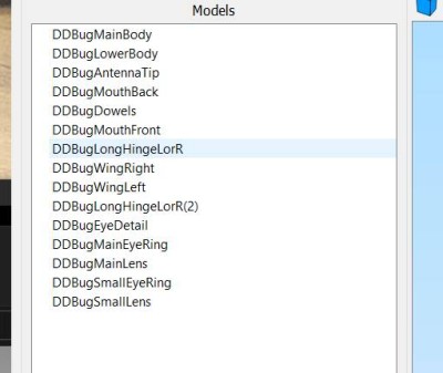

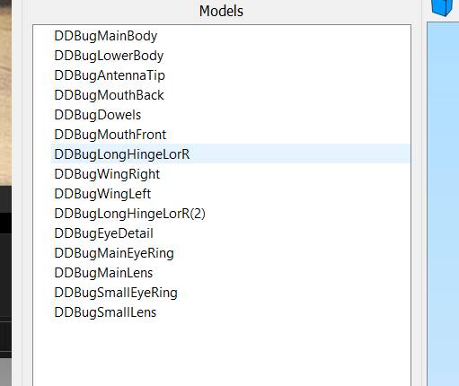

In the V4 software, the checkboxes didn't change what was printed at all. It was just a visual toggle, but the part would still be printed. So if you have 10 parts positioned off the bed like in your screenshot, it would have caused big problems with V4 as well.
If you want to change what parts are printed, just double-click on your process and click the "Select Models" button in the bottom left. Any models that aren't selected won't be printed.
