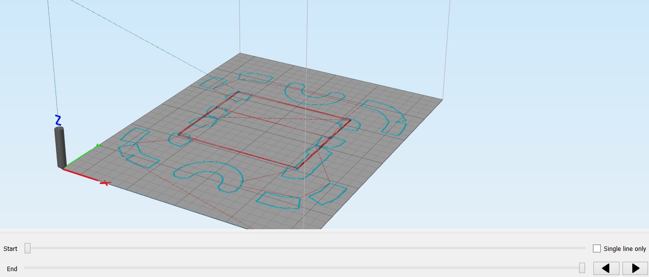

I have problem slicing this model in S3D. It just generate a few toothpath in the preview.
I tried same model in cura and toothpath generated is ok.
Can anyone comment what is the problem? Thanks in advance ;)

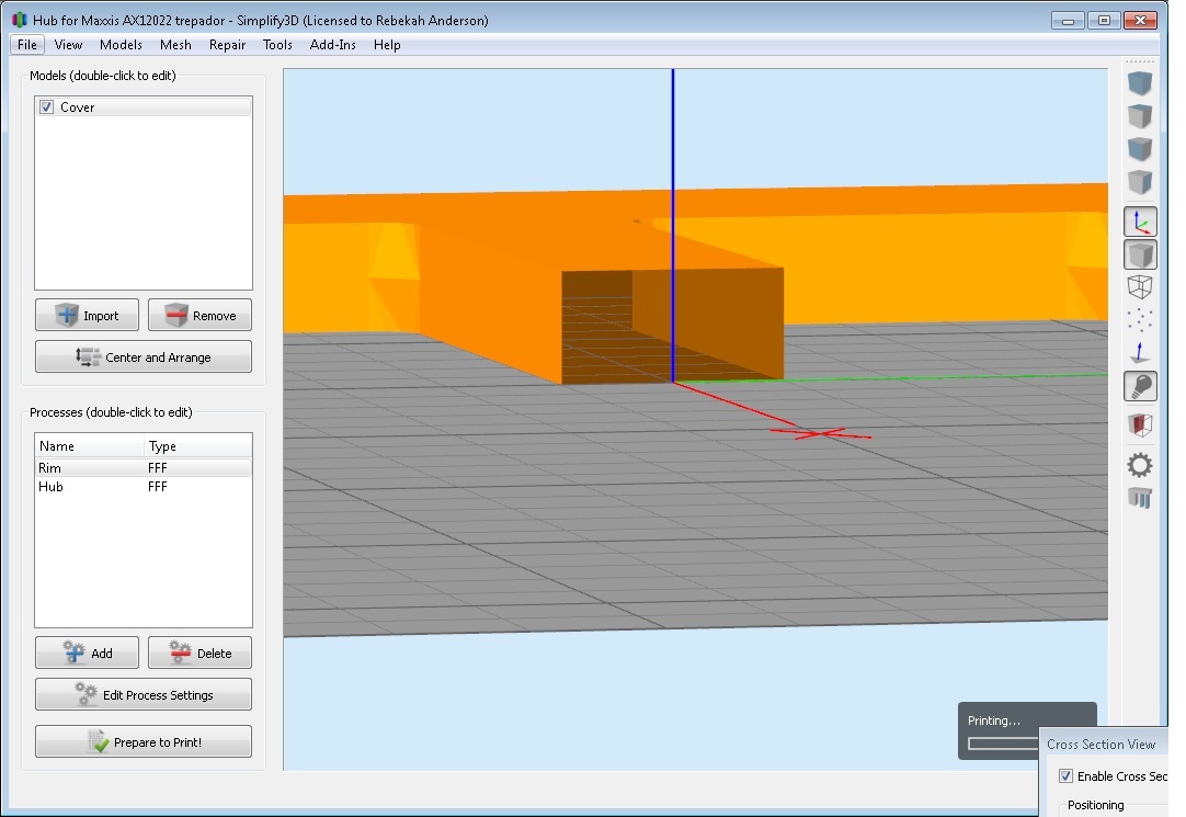

Rebekah_harper
Posts: 263
Re: Slicing Problem
I think the problem is that your part has no volume.
here is your part in S£D with the crossectional view. and to me it looks like it was made out of a mesh and isn't a solid.
if there is no mass or the walls are too thin for your nozzle to deal with it won't give you a preview nor would it print.
