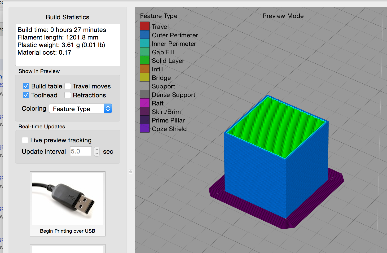

I tested and brim worked for me in a quick test. Do you get this on all parts, or just the model in the video?

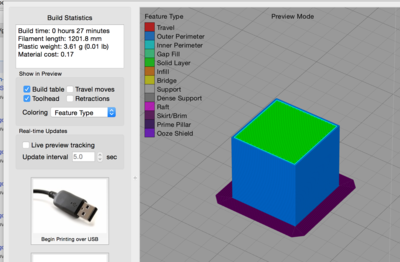

KeyboardWarrior wrote:I tested and brim worked for me in a quick test. Do you get this on all parts, or just the model in the video?
I have tried several models but for me S3D 3.0 does not generate skirt/brim at all.
