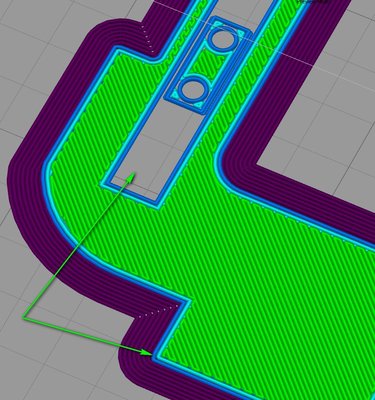

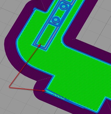

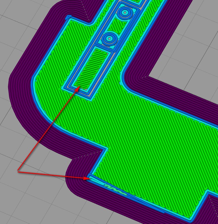

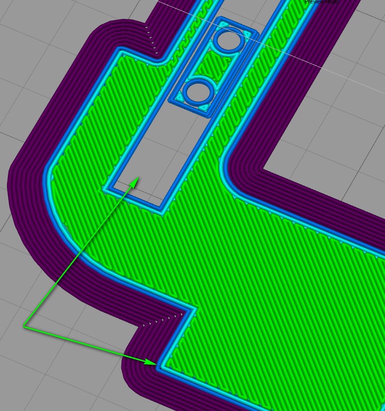

About slicing behavior:
I've load again the factory file with files names content odds characters.
Prepare to print -> all are ok
Make some modifications in the Process1
- First layer from 90% to 100%
- Skirt outlines from 8 to 10
- primary extruded from 240 to 235
Then all goes wrong, slice with strange behavior!
And even if I reload the factory files slice behaviors are still here.
This is correct
This is correct
Strange behavior slicing
