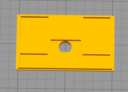

Not printing details of stl file
As Shown when imported
I have 2 stl files that will not print as shown in the stl import.

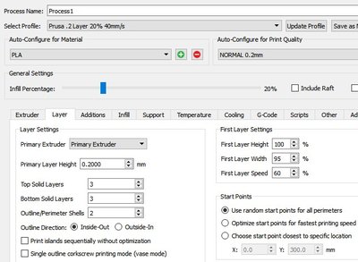

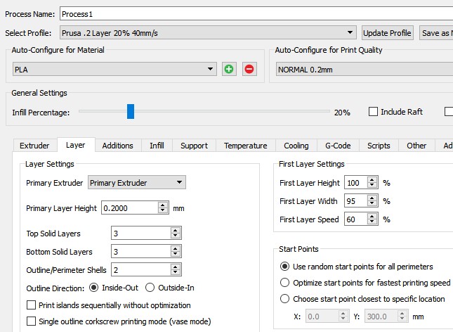

Standard Prusa Setup

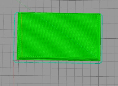

Details not Printed
Details not Printed
endcap Print Preview.jpg (27.07 KiB) Viewed 5344 times

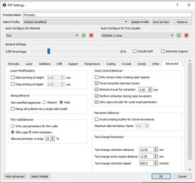

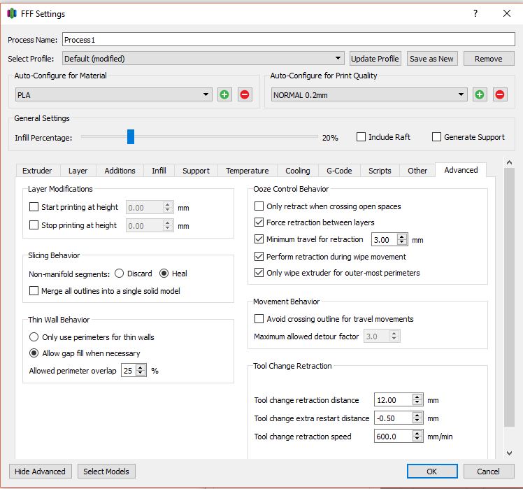

Go to the advanced tab and deselect 'merge all outlines into single model'.
carlbeck
Posts: 10
Joined: Thu Aug 25, 2016 10:36 am
Re: Not printing details of stl file
Thank you very much. I would have never thought of that. I assumed when you installed it, those boxes would be correct for default printing. But: Then again I know what it means to ass u me. :)
