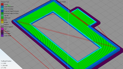

have a look to the attached pic.
Its a small cover like a frame I have printed and for testing I have switched the starting point to X=0 Y=0
As you can see, the real starting points are indead near X=0 and Y=0 (edge on lefthand side), the small tongue has no wall around, therefor the printhead jumps from one side to the other side, thats not a real starting point.

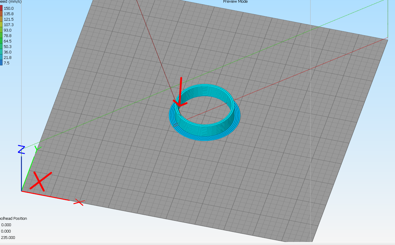

using 4.0.1 here with
Print Island Sequentially without optimization UNCHECKED

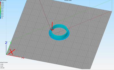

target at 0,0 front left
target at 100,100 back right
with it checked it ignores the start point point.
