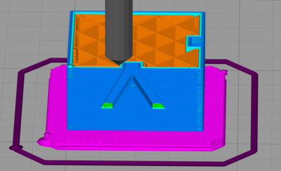

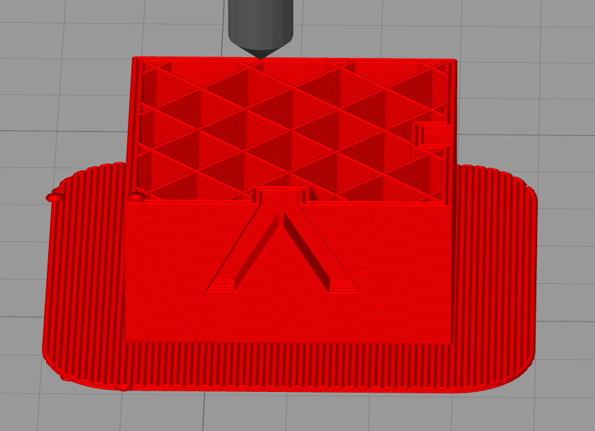

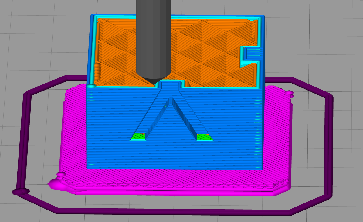

deZeus
Calibrationcubes
Calibrationcubes
Calibrationcube_S3D
Calibrationcube_S3D
Calibrationcube_Cura

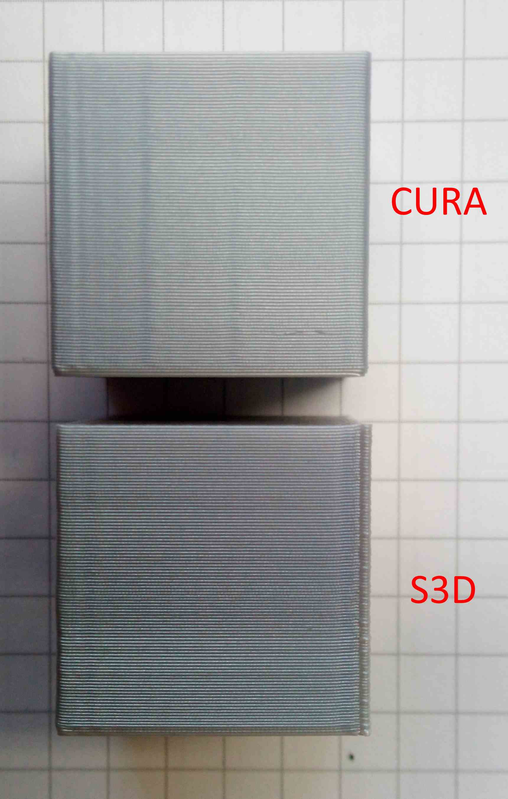

thank you for your help. I have attached a photo and the gcode files of the two cubes and below, there ist a snippet of the retraction gcode. The picture shows the retraction blobs on the right side.

Well it looks like one of those is printing the infill before the perimeters, which means if never does a retraction on the perimeters at all. So it isn't really even comparing retraction settings, since one is never retracting there.
You could try going into the Advanced tab in S3D and disabling the "force retraction between layers" option. Then S3D won't be doing extra retractions either.
Might also be interesting to see if printing 3 outlines instead of 2 improves things at all
