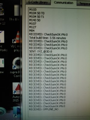

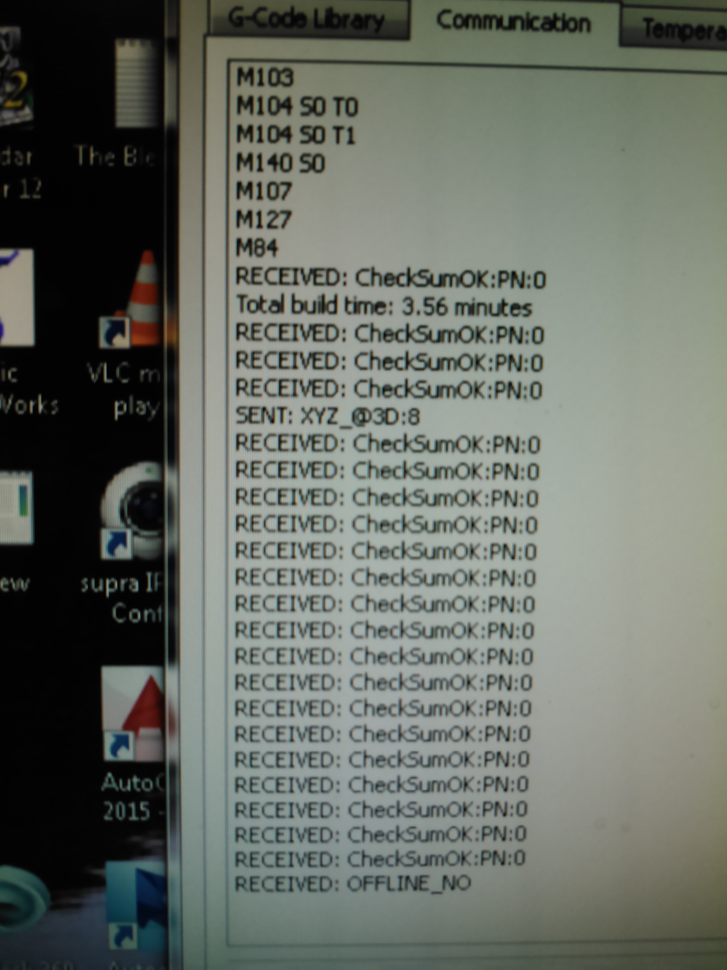

Was wondering if anyone has seen this when printing through USB, using S3D,
I have a Da Vinci 2.0, when trying to print large prints I get this( picture attached ) RECEIVED: OFFLINE_NO on the send G-Code page.
I can send small prints just fine.
JoeJ wrote:It means either something is wrong with the da vinci firmware or that the file upload failed. For example, I think you can get that if the SD card fills up or sometimes when you trigger a bug in the firmware. Try sending a smaller file. Does that work?
