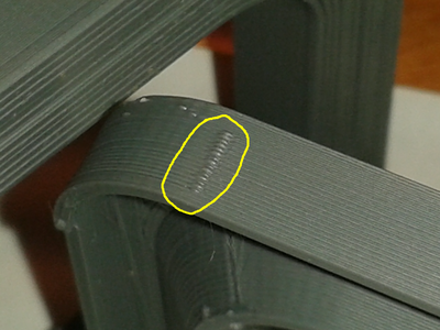

Here is the real existing print:
The objects high is 6 mm and the nobbles are caused only by my settings without a Restart value (normal used -0,13 for ABS and PLA but this is a new special filament. Lift also set to zero).
