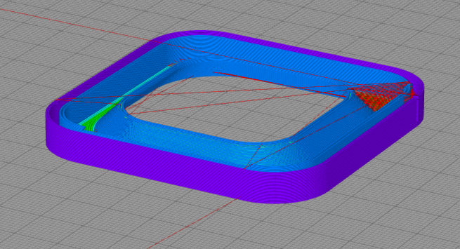

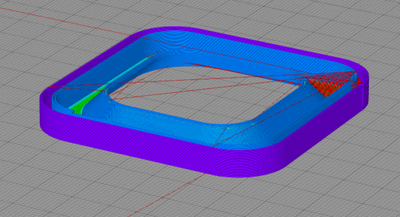

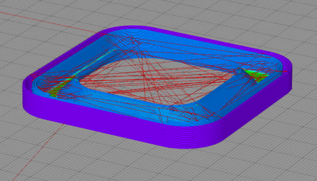

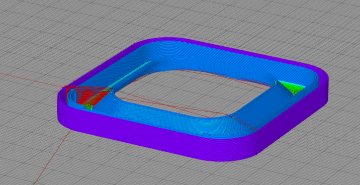

Here are attached another exemple with settings as every day, only the ooze shield is set for demonstration and shows definitivly the startpoint near X0 / Y0 and near X200 / Y200 when the print head changes between the model and the ooze shield.
The 3rd picture shows the same with setting to Random Start Point.
S3D 4.0.1 on Win 7 Prof.
H.

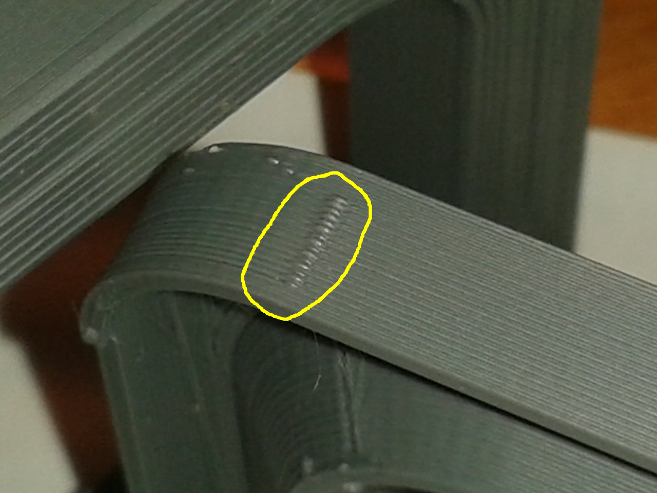

Here is the real existing print:
The objects high is 6 mm and the nobbles are caused only by my settings without a Restart value (normal used -0,13 for ABS and PLA but this is a new special filament. Lift also set to zero).

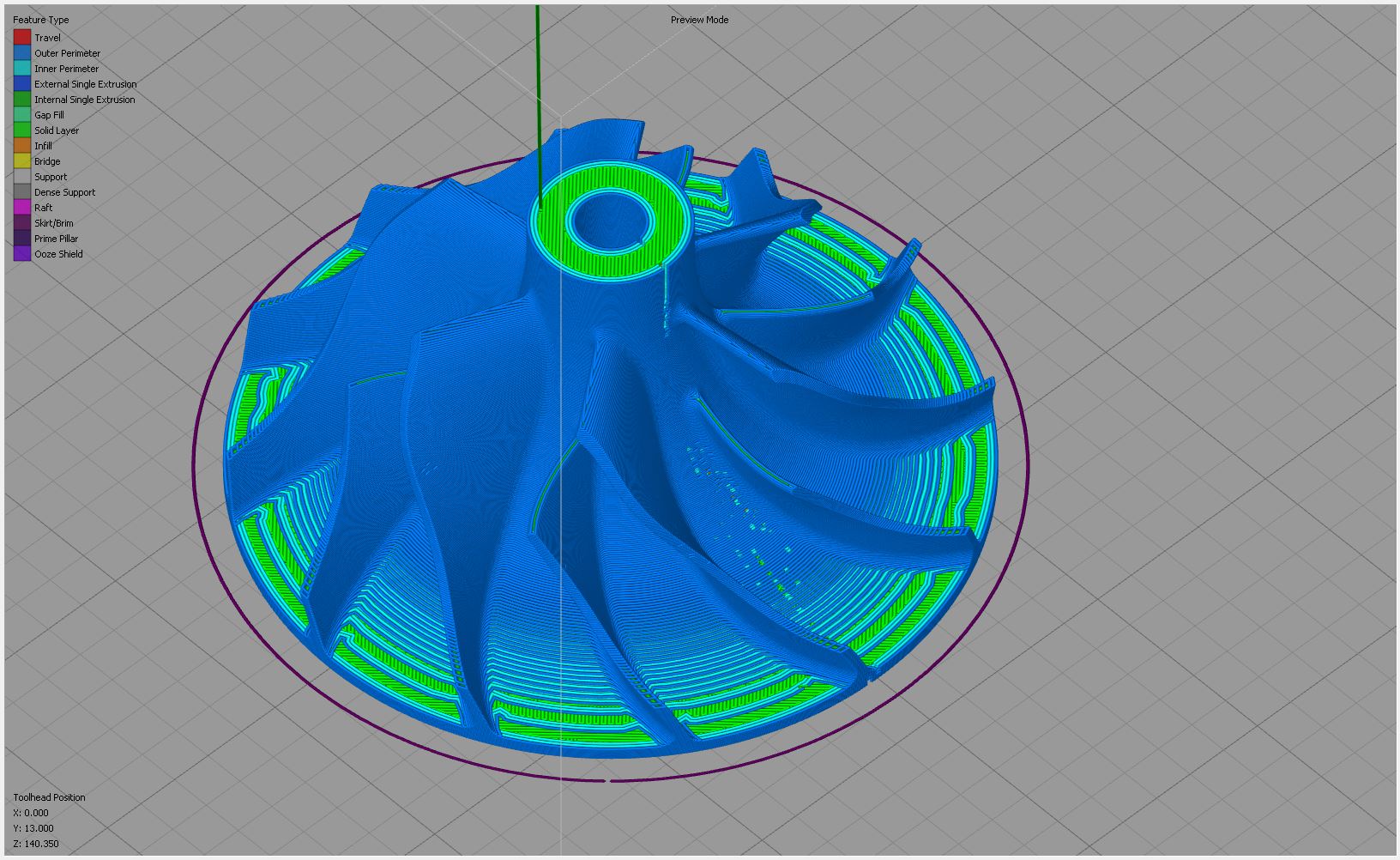

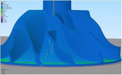

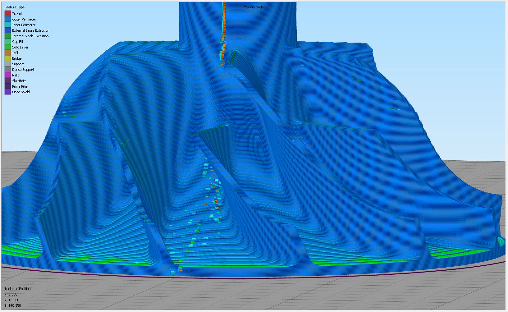

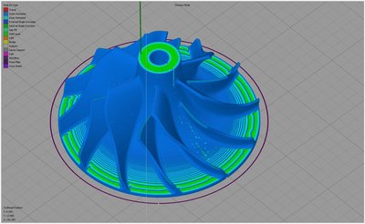

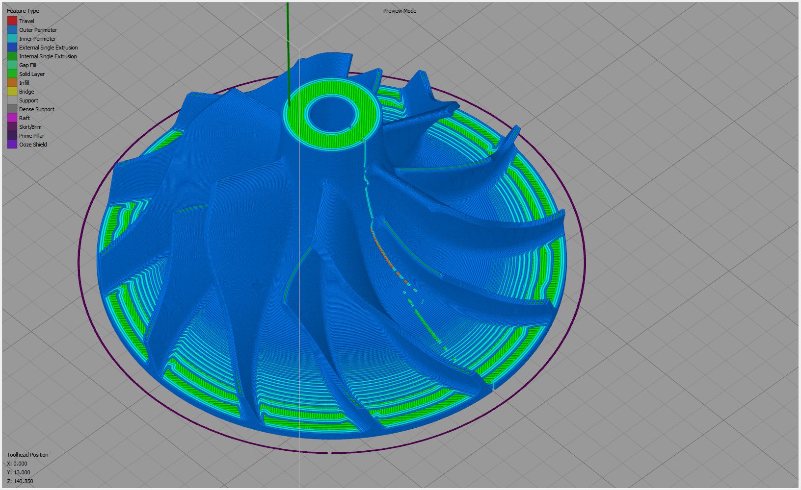

Another example:
I have the start point set near the center of the part - offset slightly to one side so i should get a 'zipper' up the side. i don't want any start points on the vanes. here's what it looks like in 4.0 (this is what i want to have)
If i slice this in 4.1 I get scattered start points, and some of them are out on the vanes which clearly are not the closest point to the specified coordinates.
