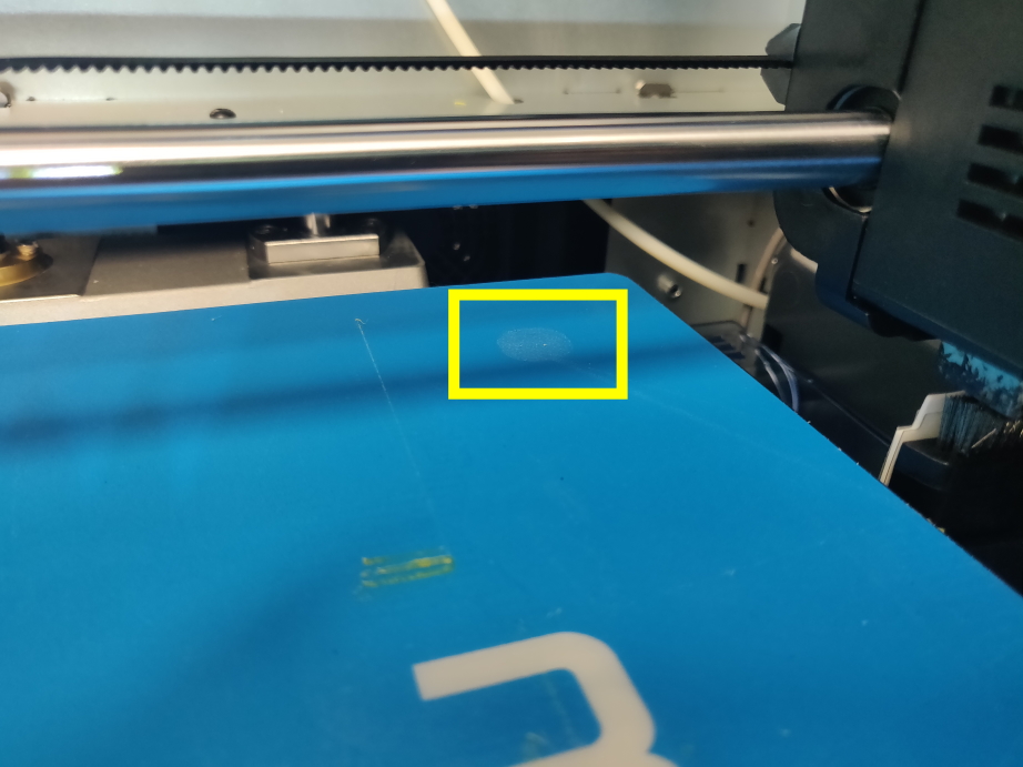

This is a 100% Fully working profile for ditto printing as it should be. it now says duplication mode on the screen and has the correct distance between the nozzles. You are able to cancel 1 nozzle if their is a failure on one side.
It looks messy in the script section but this works exactly the same as flashprint so please don't edit anything in their unless you know what you are doing.
It saves the file in a .g format which you can open in flashprint and send to the printer over a network connection or just save to the USB stick.
I got this working by creating a CalPad in the top right corner, this is to level the nozzles but I used it just to get it to create the correct spacing apart for the nozzles.
It will do the circle in the top right corner which the right nozzle does first before both nozzles begin the raft process in duplication mode.
I have also supplied a .g file which you can test out. This is ABS 235 Nozzle 120 Bed. This was made using the new profile I have uploaded.

The profile I uploaded places a calibration pad into the top right corner of the build plate. After this, the right nozzle and left nozzle work to half the build plate each and builds the actual model as required. I use a bigger raft to compensate for the height difference between the nozzles.
If it does not do the calibration pad in the top right corner first, it will not correctly locate the extruders so they use half the build plate each.

If you use the profile I have supplied "Version 2" check to make sure the start script inlcudes the gcode you can see in the image.
Also make sure the additional terminal commands looks the same as the image.
You can then open up your generated g code to ensure the calpad has been added into the file.
If you have issues, if you can create a file with a random object, send me over the gcode file and I can see if something is missing.
