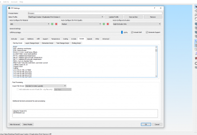

This is a 100% Fully working profile for ditto printing as it should be. it now says duplication mode on the screen and has the correct distance between the nozzles. You are able to cancel 1 nozzle if their is a failure on one side.
It looks messy in the script section but this works exactly the same as flashprint so please don't edit anything in their unless you know what you are doing.
It saves the file in a .g format which you can open in flashprint and send to the printer over a network connection or just save to the USB stick.
I got this working by creating a CalPad in the top right corner, this is to level the nozzles but I used it just to get it to create the correct spacing apart for the nozzles.
It will do the circle in the top right corner which the right nozzle does first before both nozzles begin the raft process in duplication mode.
I have also supplied a .g file which you can test out. This is ABS 235 Nozzle 120 Bed. This was made using the new profile I have uploaded.

JoshuaYates
Posts: 31
Joined: Wed Jul 08, 2015 10:17 am
Re: Flashforge Creator3
Mon Oct 07, 2019 10:16 am
john_s_sub wrote:
Wed Oct 02, 2019 10:05 am
Hi Joshua,
Tried the fff config however it appears (at least for me) the duplicate printing is trending to the left. So what happens is that either though it appears ok in flashprint the left hand side of the right extruder print, prints over the top of the right hand side of the left extruder print.
Can you point me where I need to change x y setting to push the prints into their right areas of the build plate? thanks
Also, need to be careful cancelling single extruder (i did the right) - left knocked the right extruder when i went to cancel it
Hello,
I'm not sure I understand the issue you are having.
The profile I uploaded places a calibration pad into the top right corner of the build plate. After this, the right nozzle and left nozzle work to half the build plate each and builds the actual model as required. I use a bigger raft to compensate for the height difference between the nozzles.
If it does not do the calibration pad in the top right corner first, it will not correctly locate the extruders so they use half the build plate each.
I've reattached the one I use to date with any modifications I have added since my last upload.
FlashForge Creator 3 Duplication Print Version 2.fff
(53.13 KiB) Downloaded 22 times
JoshuaYates
Posts: 31
Mon Oct 07, 2019 10:25 am
If you use the profile I have supplied "Version 2" check to make sure the start script inlcudes the gcode you can see in the image.
Also make sure the additional terminal commands looks the same as the image.
You can then open up your generated g code to ensure the calpad has been added into the file.
If you have issues, if you can create a file with a random object, send me over the gcode file and I can see if something is missing.
